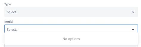

This means that as you are filling in the Asset, you select Company attribute first in current schema. And then when you click the Location drop down, the list will only show Locations based on the Company you selected just prior to it. If no company is selected, then no locations will show.
I have done this same thing in my system with Asset Types and Models.
As an example: I have no Type Selected so my Model drop down shows No Options

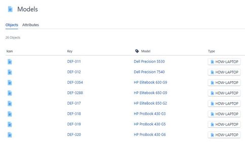

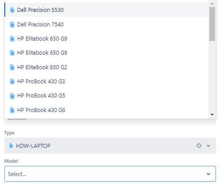

When I select Type as HDW-Laptop, now you can see my Model drop down is Filtered to All Models with a Type as a Laptop (sorry my screenshot is weird. The drop down actually drops up, not down)
This is the Asset View showing all models with type HDW-Laptop:
