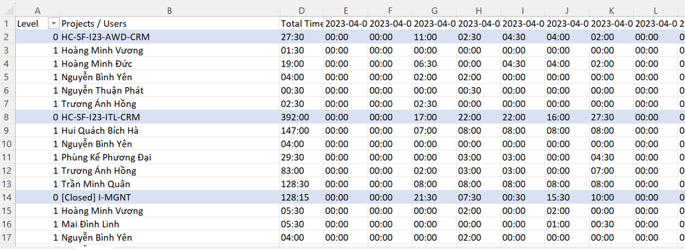

I'm in trouble with clockwork - an add on in Jira. I'm trying to export the work log in Clockwork into excel file but recognized that project and users are in a same column.

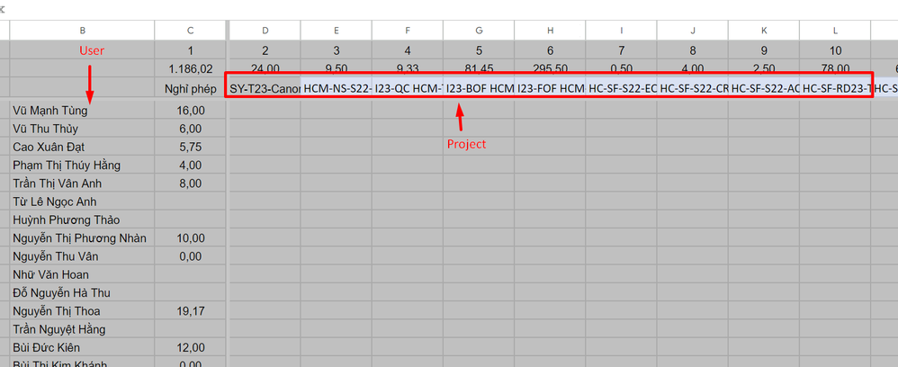

I wonder is there anyway that can make projects and users turn into 2 dividend columns or turn into column and row. For example, like this
If you have any idea please let me know. I really need your solution since this is a requirement from my colleague and we cannot use the frame that have projects and users in a same column

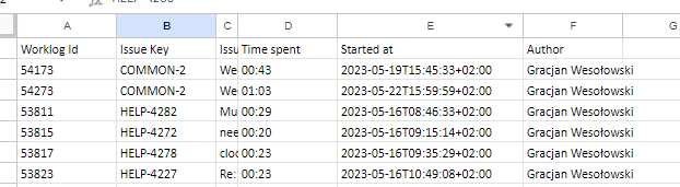

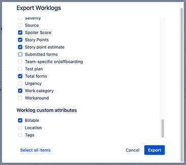

I understand that you are using the Timesheet export option. What you can do is you can Export Worklogs, and choose which worklogs, and custom fields you would like to include there. The export would for example look like this:
You would have each issue, user, and time spent in different columns. You can include more than this, and configure it as you prefer.

Thank you for your help Gracjan! The worklogs did not work for me since it do not have a field that I need which is assignee, I would love to get in touch with your team via help center to find a way with the macro.
