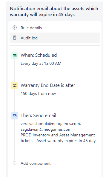

I am trying to create an email notification in order to receive a list of the tickets in which a warranty end date will finish in 45 days. Adding here a screenshot of the automation created. It does not work for me and I can't find a solution how to fix it till now.

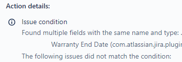

The issue I get in audit log after running a rule is:
Found multiple fields with the same name and type: Warranty end date. How can I fix it without risking to loose all the info in the Warranty end date field in the tasks retrospectively.
I believe i need to have a new specialized Warranty end date field. but maybe there are more workarounds?

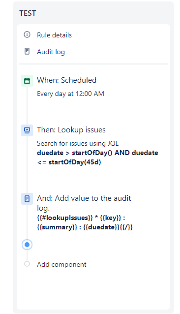

Evgenii
July 10, 2023
Ok, no problems. If you're looking for Issues with such custom field, you have to make rule like in my example. Replace duedate with your field, and instead of adding values to log, add smart values to email body.

Evgenii
July 11, 2023
No, that's just an example, to show, how it works.
You can add such block to email body template, and replace duedate with "Warranty  End Date", for example

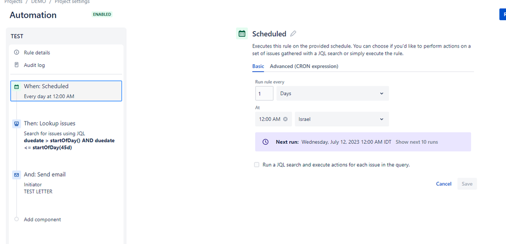

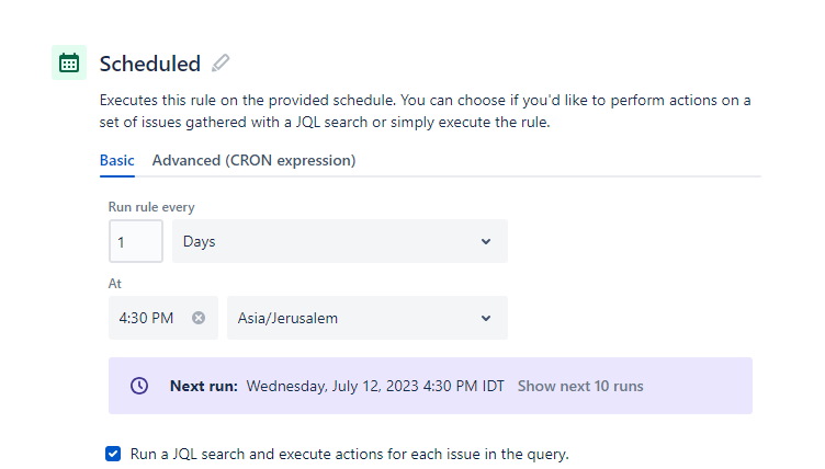

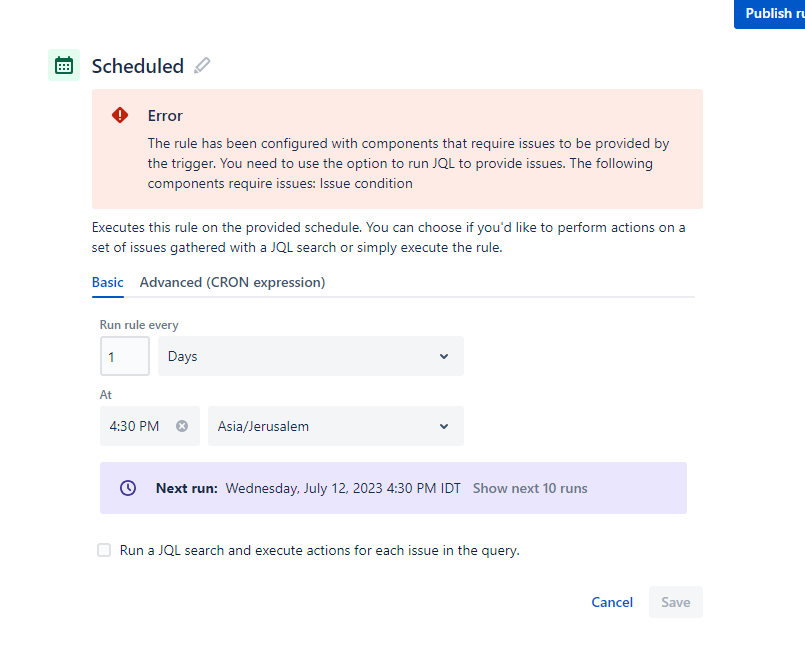

Thanks! Its really helpful. I am using Lookup issue's part but in the When "Scheduled part I am asked to mark a part - Run a JQL search and execute actions for each issue in the query. If I save the rule without choosing this part it says that i must add a JQL.Screenshot 2023-07-11 165322.pngScreenshot 2023-07-11 165201.png
Evgenii
July 11, 2023
It's very strange, because in my similar rule there is no need to set JQL. Looks like, that some of actions, you added o rule, require selection of issues. Try to refactor rule.
Vera Valshonok
July 12, 2023
Thanks! IT worked! Really appreciate your help
