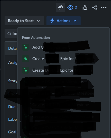

Hello @Ellen Gruebbeling
I can think of a simpler way to achieve this. Create a Manually triggered automation and associate it with your ticket type. Instead of having to change the status of an issue to "Add Issue A", the user would execute the manual trigger via the Actions menu. I use this to create Epics in other projects and link them back to the trigger issue.
This will leave your issue status unchanged as you are looking for and is a simpler automation to implement.
Ellen Gruebbeling
January 8, 2025
Hi @Ted Nieblas this is a great idea and may be a preferred solution for our team, especially if the manual triggers can be limited to be triggered by only select team members. I appreciate your assistance!
