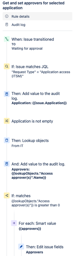

I have multiple automations because we are using tray.io to do some of the automation like getting the manager and notify them and the system owner via Slack and add the user to the right Okta group. We store the application information in Insight, so the automation to get the system owner looks like this:
