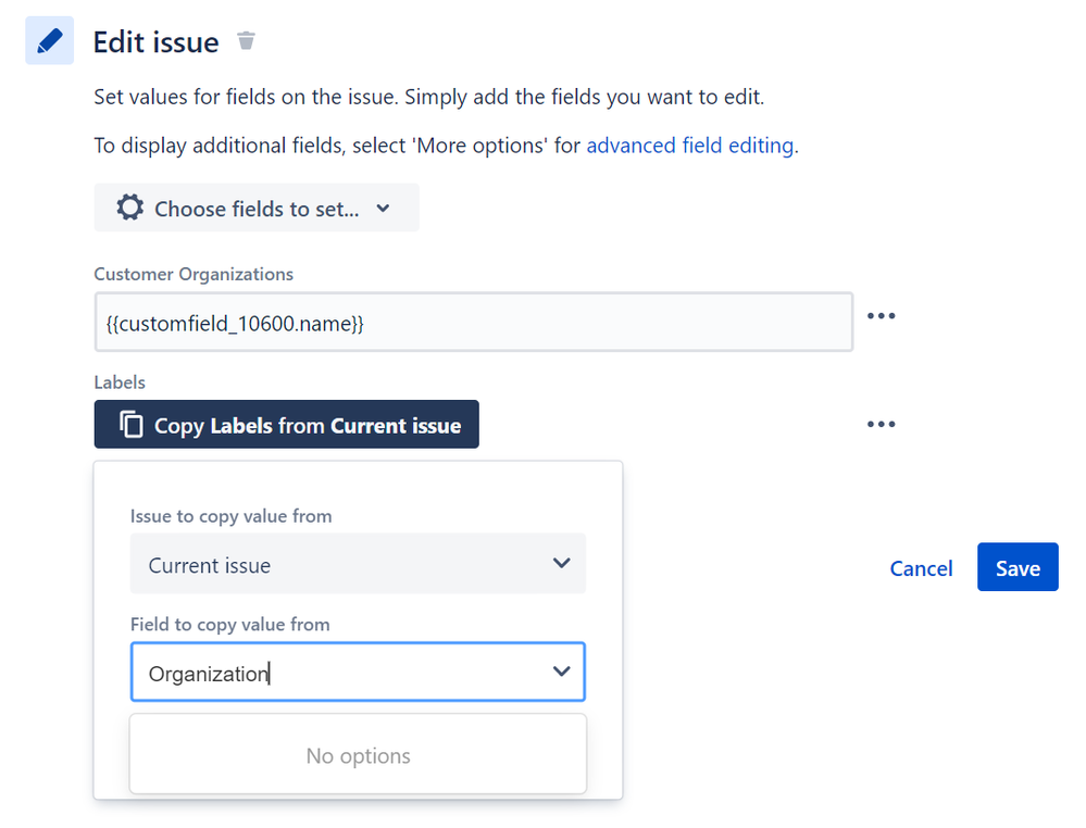

I was able to take the info from the Organizations field in customer support tickets and put it into a read-only text field. (see screenshot)
But I'd prefer to have each organization of that ticket to be added as a separate Label.
Unfortunately the Organization field doesn't seem to be available in the Automation to choose from as an input field for Labels. (see screenshot)
Is there maybe a way to achieve this with custom JSON code?

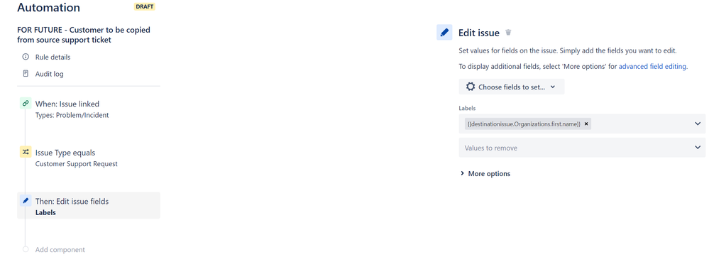

Christian Happel
July 31, 2022
Hi @Jack Brickey ,
first of all thanks for your response! I tried it out but unfortunately don't get it to work. But this could also be because I didn't describe my problem properly:
I want to set the labels not on the original customer-support ticket, but only when someone links a Jira development ticket to this support ticket.
So somehow I need to define the automation in the Jira dev project to run whenever someone links it to a support ticket, and then pick the Organization from the destination (support) ticket and put it into the labels of the dev ticket.
If you know how to achieve this, could you make me a screenshot of that part of the edit-issue-step in the automation?
Thanks so much, Christian
Christian Happel
July 31, 2022
@Jack Brickey
I got it. In the end I only had to use
{{destinationissue.Organizations.first.name}}
 in the Set Value field of the label.
Thanks so much for this hint!
Christian Happel
July 31, 2022
@Jack Brickey Well, I ran into one more problem here: It's only taking the first Organization into the labels. But in case there are multiple organizations assigned, those aren't adding any labels.
Any idea on this one?

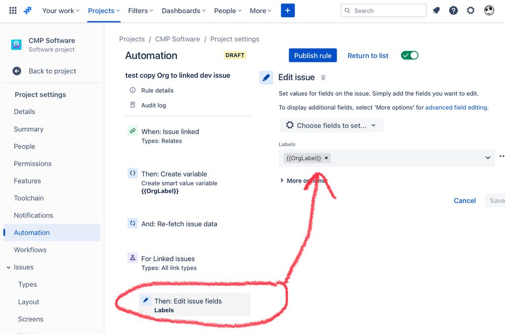

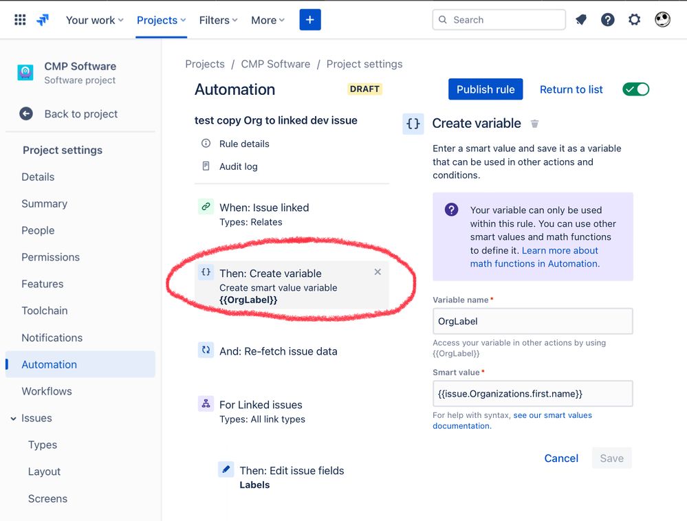

Jack Brickey
July 31, 2022
Hi @Christian Happel ,
I was trying that same thing but could not get it working. Please post the full rule here for others.
Here is what I came up with...
The process is to link the JSM to the JSW from the JSW issue. This could be reversed I think.
I used the Create variable action to store the Organization into a smartvalue. I then referenced the variable in my action to add the label.
Regarding the issue of multiple organizations I'm not sure TBH. Will need to play with it.

Christian Happel
August 1, 2022
@Jack Brickey
I'm doing it in the JSW project and pulling the data from the JSM ticket.
I didn't use any variable. See here:
