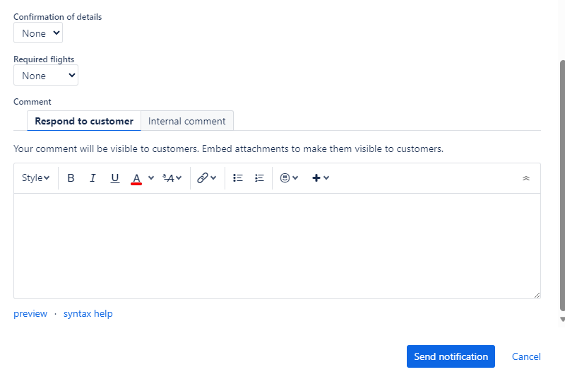

I did also notice that when I transition the status to Publish to business and a window appears the field does not seem to appear on the window where this can be found in the screenshot below

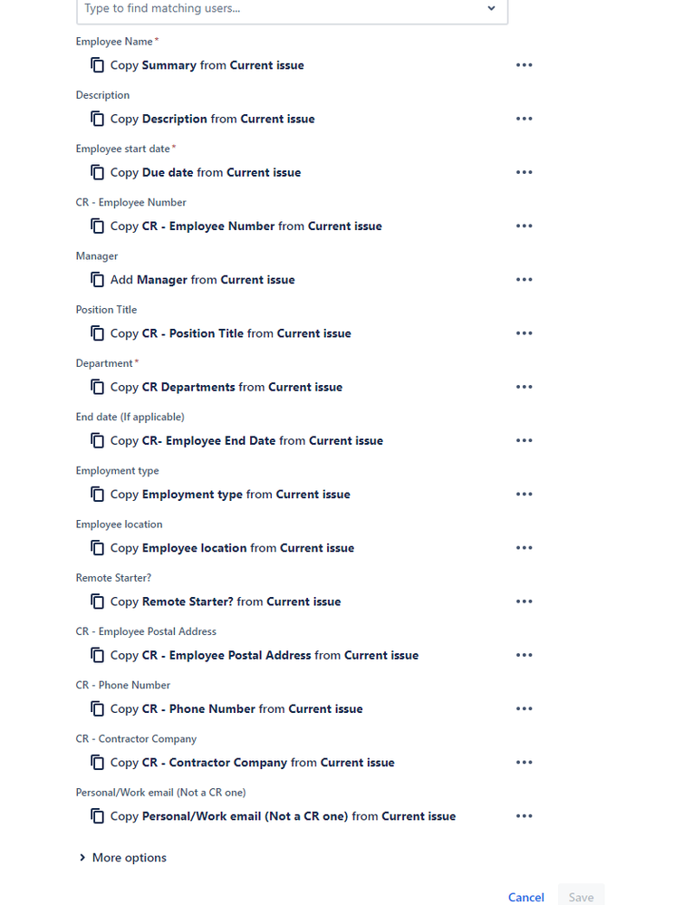

Can you show us the details of the rule step where you are copying that data?
To add a field to a transition screen you will need to identify the screen used in the transition and then update that screen. You can find the screen associated to a transition from viewing that transition's information from the Workflow Editor screen. Then you can change the fields on that screen from Jira Administration > Issues > Screens.

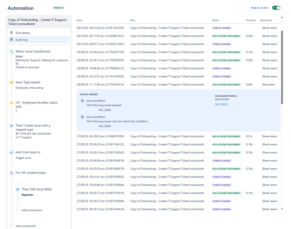

In the Audit Log information you provided on October 2 it shows No Actions Performed.
In those cases, the new issue is not being created when the rule runs.
For the specific execution you showed, PAC-8459 was the issue that triggered the rule, but it did not meet the second (CR - Employee Number starts with C) of the two conditions you specified so the step to create an additional issue was not executed.
If no new issue is created, then certainly data could not be copied from the source issue.
In an earlier response on Sept. 28 you indicated that PAC-8474 was an issue that triggered execution of the rule. However, the Audit Log screen you shared shows the status of all rule executions since Sept. 27 has been No Actions Performed, which means that rule has not created any new issues.
If new issues are being created by Automation, it is not being done by that rule.

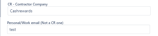

the custom fields that are not copying across are named:
CR - Contractor Company
Personal/Work email (Not a CR one)

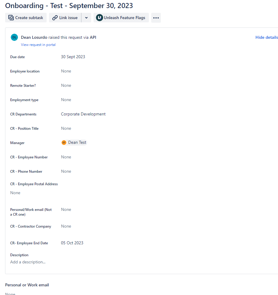

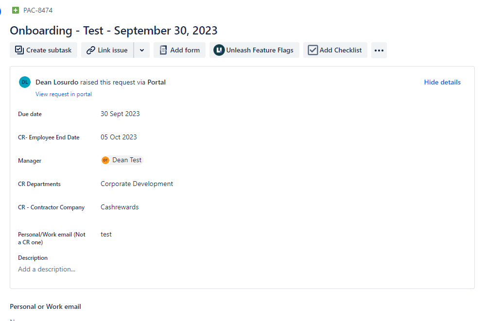

As seen in the screenshots below this is what data is in the field but when it gets copied to the next ticket nothing come through. I have also attached a screenshot of the automationfieldss not working.png
This is the ticket created from the automation. You can see the corporate development and manager fields have copied across but the two mentioned before havent.

I have attached a screenshot of the automation rule for you. The highlighted rule in the audit log is the one for the ticket seen in the screenshots above. rule .png
