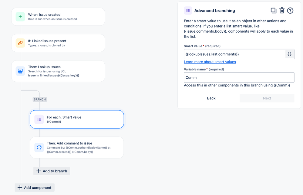

I stumbled upon this discussion on the topic and following the linked knowledge base article to set up the automation rule like for like (below) but it never gets triggered and I have no idea why.
The only thing I can think of is that the trigger issue is from a different project. Anyone can help me solve this?

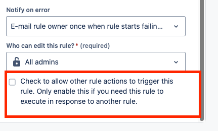

If the issue creation is being done in another Automation Rule then in this rule you must check the box on the Rule Details page:
That should solve the problem of the rule not being triggered.

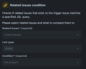

in an another automation rule I've created to clone tickets across projects, I've set the condition to link the tickets by the link type "is delivered by" so I should adjust the link type of the "If: Linked issues present" condition to reflect that. Am I right?
Yes, you would need to change the condition in this rule to match the link type you are actually using to link the issues together.

The message in the log indicates that the rule is not passing the first condition where you are checking for type of links. Updating the condition to look for the link type you actually use should get you farther.

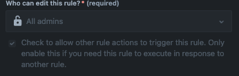

@Trudy P Claspill I have ticked the box within Rule details:

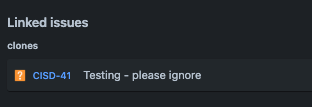

The link type within the first condition matches the type in the ticket:
But it's still not passing the first condition:

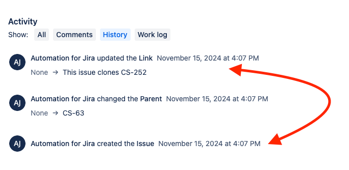

I suspect that the action that is creating the Clones link between the issues is happening after the new issue is created. This rule is triggered when the issue is created, and executes before the link is created.
I created an Automation rule that uses the Clone Issue action, and within that action I updated the Linked Issues field to link the new issue to the source issue.
When I executed that rule, the history of the newly created issue shows that the issue was created and then separately the link was added.
Try adding a Re-fetch Data action or a Delay action after the trigger. Re-fetch may also happen too fast, before the link is created.
