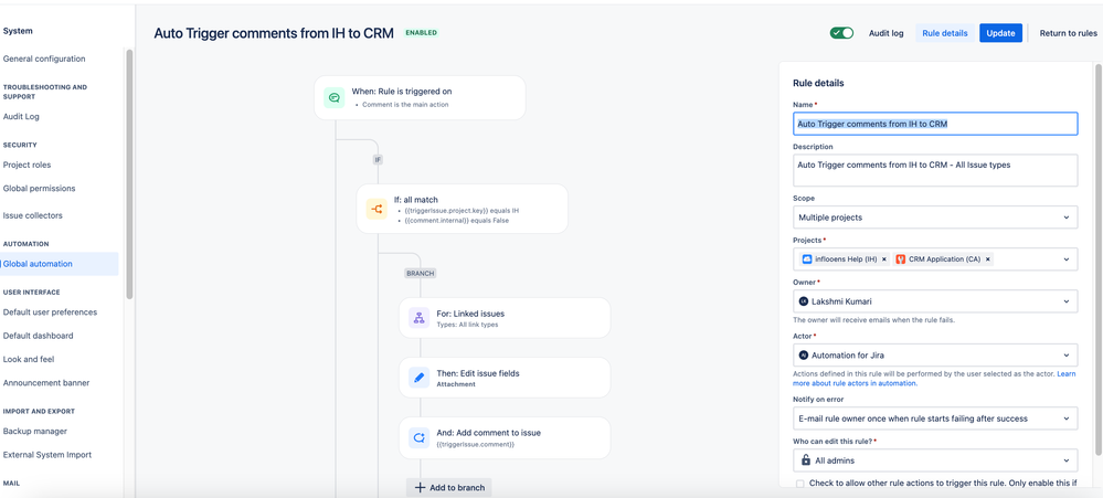

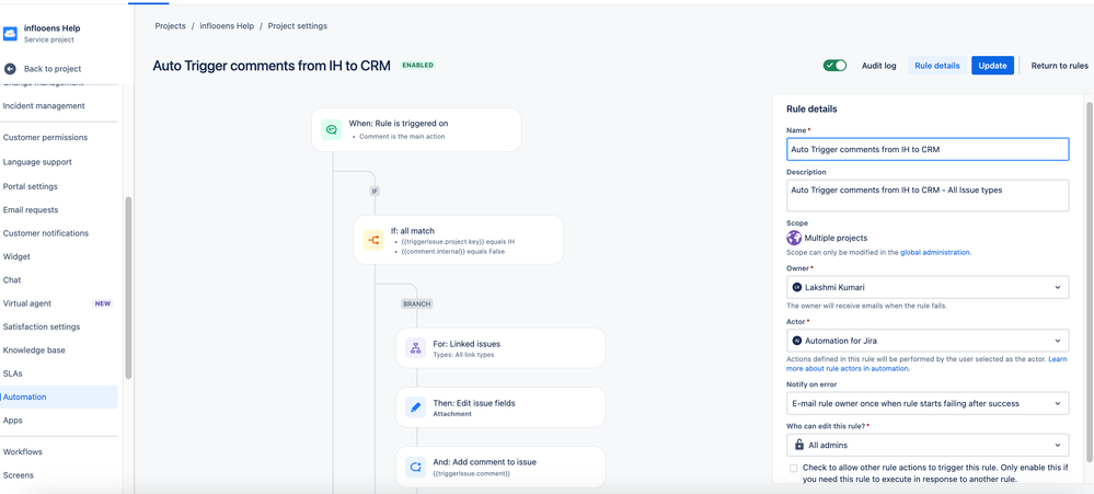

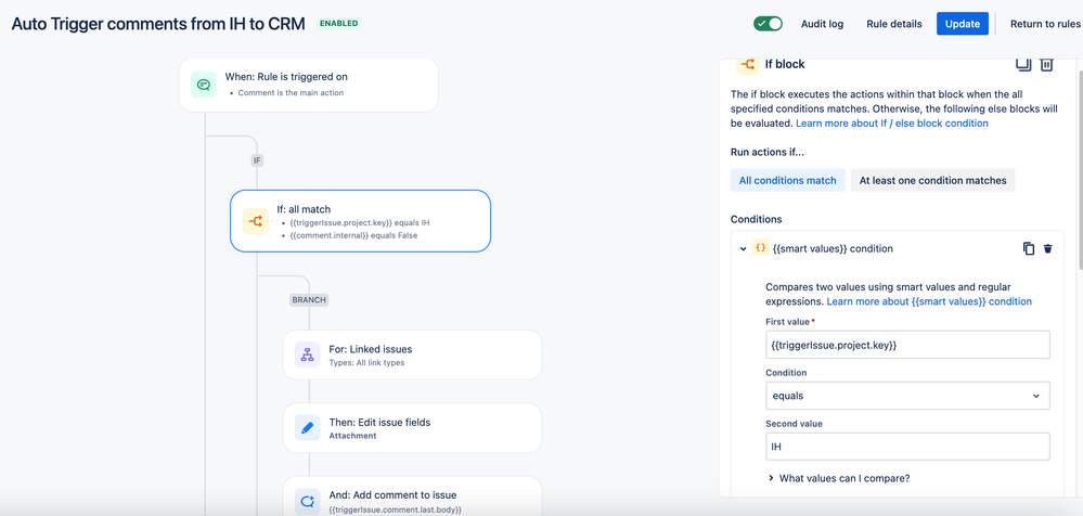

Hi,
I manage multiple projects hence I am supposed to create external (Service desk projects) and internal projects which needs to be linked to each other.. I created an automation rule to auto trigger the comments from service desk project to the linked project (internal project) but it's not working. Attached is the snapshot for your reference that shows the details of rules. Please review and confirm the detailed steps on auto trigger of comments from external to internal project..
I have already linked the Issue type triggers and it's working but auto trigger comment is not successful.
Screenshot 2024-02-04 at 2.51.21 PM.pngScreenshot 2024-02-04 at 2.52.22 PM.png
Please help.
Regards,
Lakshmi

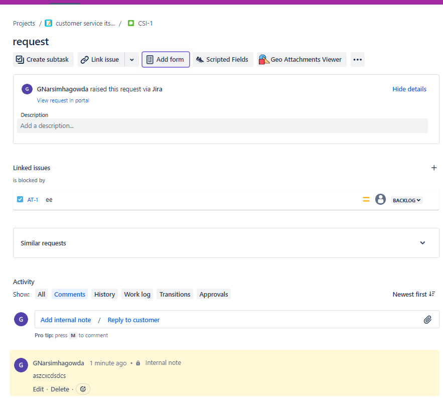

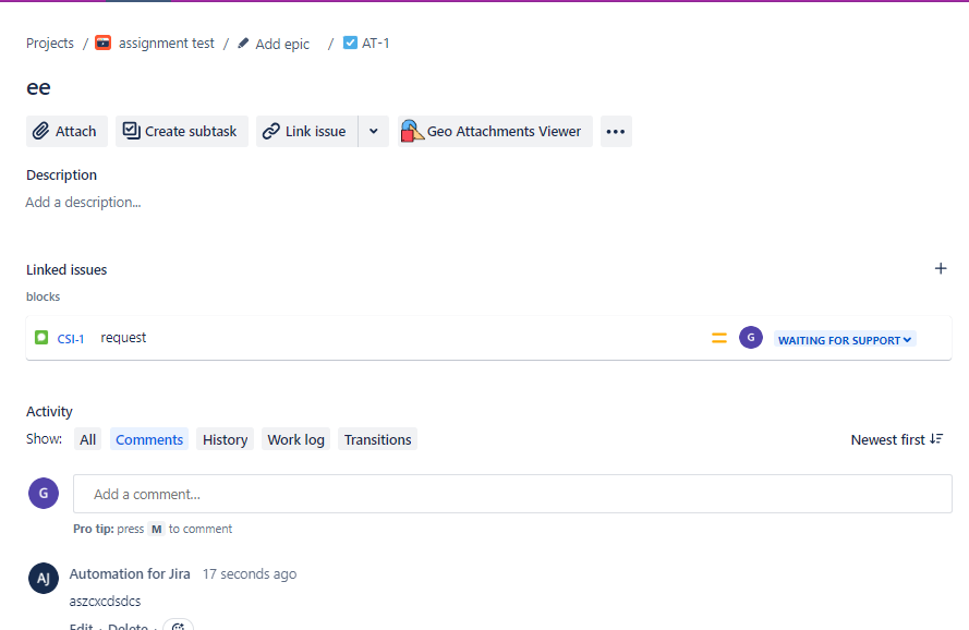

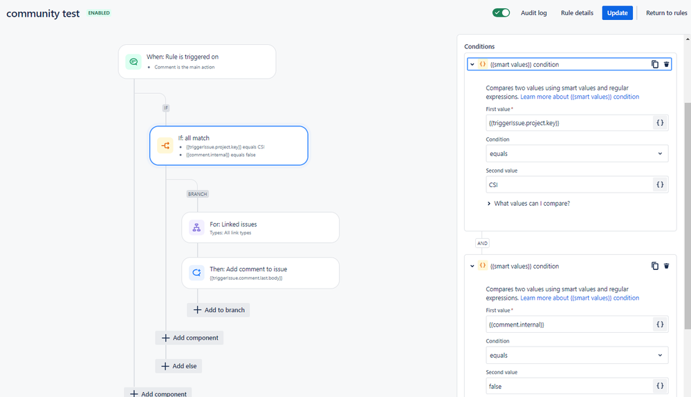

Hi @Lakshmi Kumari ,
I recreated the same automation as you suggested above it is working for me for reference i have attached the screenshot, I think you are adding internal comment because when i tried adding the internal comment i got the same message in the audit log.2024-02-05_14h51_40.png

GNarsimhagowda - Empyra
February 5, 2024
And try unticking the checkbox in the action "comment" That might be the problem!.

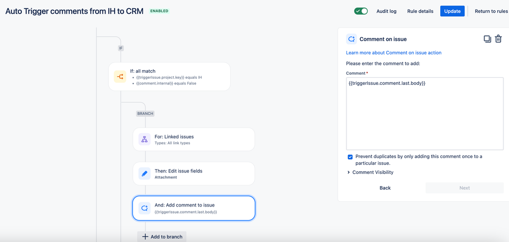

Lakshmi Kumari
February 5, 2024
Hi,
I tried deleting the 2nd condition that was updated in "IF Condition" rule section and checked the "prevent duplicates" option, it's working now... JIRA has come up with lot of updates which has affected the conditions now and back then when i created old projects...
Thanks a lot of helping me out -)
Regards,
Lakshmi
February 4, 2024

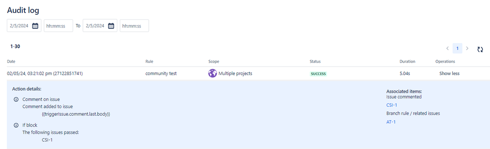

Try creating the rule in global automation,The rule is working for me instead of the "triggerissue.comment" use this "{{triggerIssue.comment.last.body}}", This will copy the last comment from the issue instead of copying all the comments everytime the automation runs.
If you are facing the issue upload the screen shot of the audit log that will be helpful to see the rootcause.

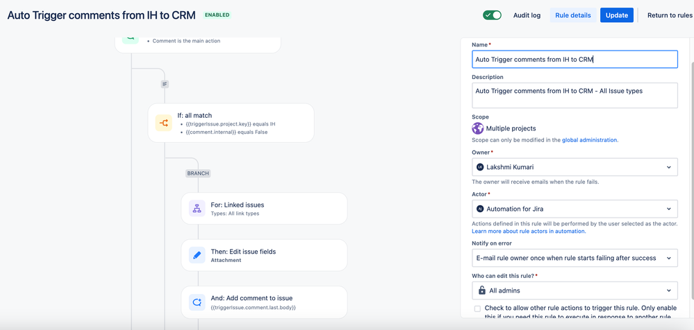

Lakshmi Kumari
February 5, 2024
Hi Narasimha,

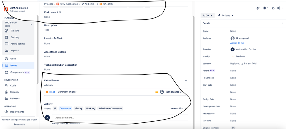

I made the changes as per your suggestion but its still not working.. Comment is still not reflecting on the linked ticket.. Attached is the snpashot for your reference.
Screenshot 2024-02-05 at 2.11.57 PM.pngScreenshot 2024-02-05 at 2.15.52 PM.pngScreenshot 2024-02-05 at 2.16.05 PM.png
Please help.
Regards,
Lakshmi
February 5, 2024
Hi can you elaborate the If Block and upload the screenshot.
Thanks
February 5, 2024
I think the problem is in the "If" block in particular "comment.internal" try removing it and check the rule will work fine!

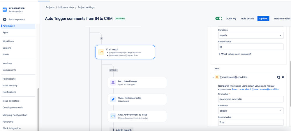

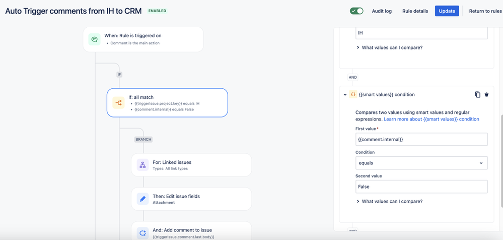

Lakshmi Kumari
February 5, 2024
Hi,

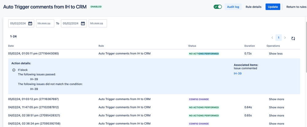

I have attached the snapshot of "If Block"...
IH is the main project (service desk for customers) and CRM is internal project meant for our staff/Dev team.. Whatever comments are updated in "Internal note" comment section in "IH" Project  (main project) needs to be automatically reflecting in CRM project too (Dev team - internal staff).. Issue type, summary description and attachment is getting triggered automatically from IH to CRM project but not comments..
Let me know if you want me to elaborate more.
Screenshot 2024-02-05 at 2.46.31 PM.pngScreenshot 2024-02-05 at 2.46.44 PM.png
February 5, 2024
Ok try just changing the "comment.internal" to "True" and it will work as expected and i have just checked it and it is working
February 5, 2024
Ok just changing the "comment.internal" to "True"  will work as expected and i have just recreated it and it is working!.

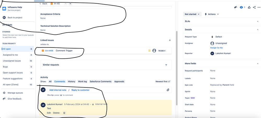

Lakshmi Kumari
February 5, 2024
Not working... -((
I have attached few snapshots for your reference.
Screenshot 2024-02-05 at 3.13.56 PM.pngScreenshot 2024-02-05 at 3.14.29 PM.png
