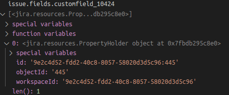

This is how a manually issue, with Insight object properly set, looks like for the customfield

After going deeper on that, just found out the syntax that worked for me.
customfield_10424=[{
"id":"{workspaceId}:445",
idk why this is not well document over jira docs, since there are similar scenarios and different syntaxes.
