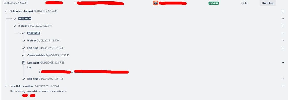

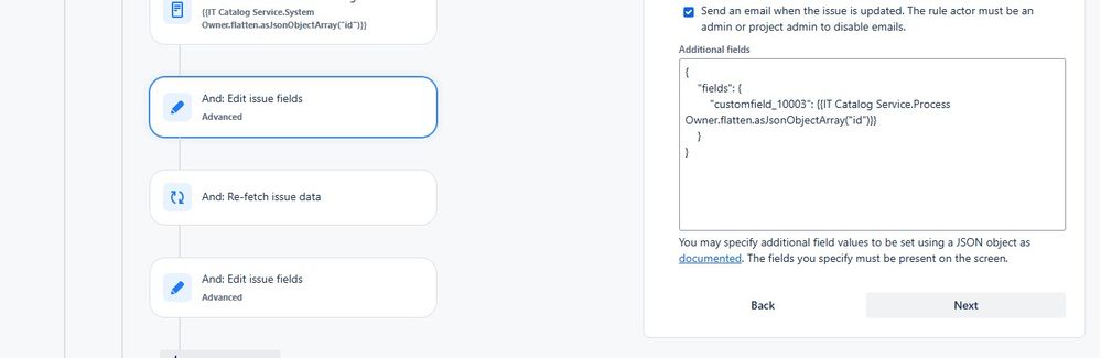

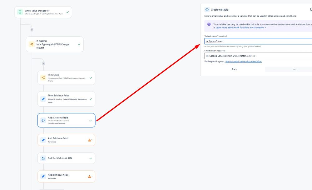

I'm able to do the first copy as I'm using "fields" option under "additional fields" with following code:
I'm doing re-fetch to give some time to the first edition be processed.

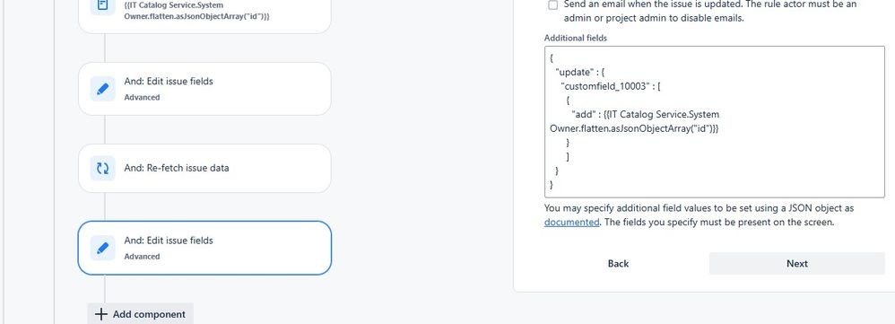

However when I'm trying to update to append the 2nd attribute users and I fail to succeed.
I'm trying this code, that is the exact strategy as for Fields option:

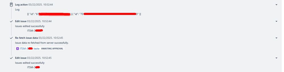

The array (id) give function gives me the id format that we need as we can see in the log.
The log says the issue was successfully edited, but data is not appended.

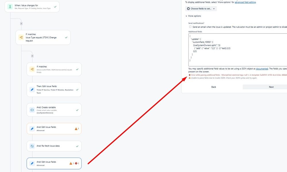

BTW tested your code and returns error:
Error while parsing additional fields - Mismatched start/end tags: null != in template-9b3fxxxxxxxxxxxx

I tried your suggestion but returned:
Hi @Bill Sheboy any suggestion on the correction of the code to overcome the error outcome?

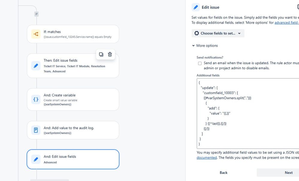

Please post images of:
Thanks!
Oops...typo as the pound sign # is missing from my earlier post. Please use this:
"update": {
"customfield_10003": [
{{#varSystemOwners.split(",")}}
"add": {
"value": "{{.}}"
} {{^last}},{{/}}
Hi @Bill Sheboy thanks for the reply, it is better but unfortunately still does not work.
I get the values in log from variable. The log says it was edited, but values are not appended to the field.
Hi,
I've manage to solve it, not in the most pretty way.
It seems that I cannot use array in update/add options.
Tested with constants and the correct syntax is this one:
"update": {
"add": { "id": "61balbalblablab" }
"add": { "id": "71blablablabla" }
So, what I've done was to create 3 variables.
{{issueField.AssetAttributeA.flatten.asJsonObjectArray("id")}}{{issueField.AssetAttributeB.flatten.asJsonObjectArray("id")}} {{varA.replace("]","")}},{{varB.replace("[","")}} Then code with fields options to set all together.
"fields": {
"customfield_10003": {{varC}}
