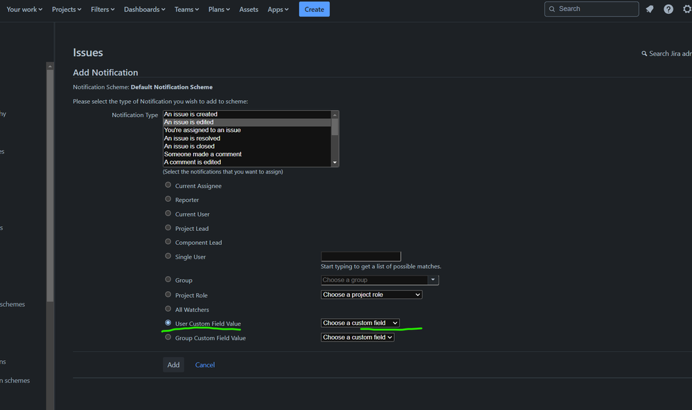

Is it possible to add a custom Field (People Picker) to the Notficatioscheme as receiver in the TO field?
Cristian0791
December 17, 2024
Hi Philipp,
You can build a use multi-picker field.
In this field you can select multiple people.
Then go to the Project->Notification->settings-> Click on Action ( Right top)-> Edit notification-> select you notification-> click add-> check: Use custom field value (here select your custom field)

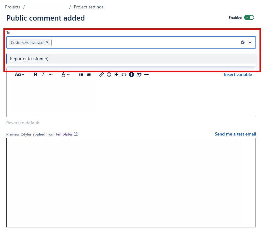

Many thanks for your fast reply. However, with this solution, I can't distinguish between internal Comments and normal Comments. I fear I will have to do this over the automation.
