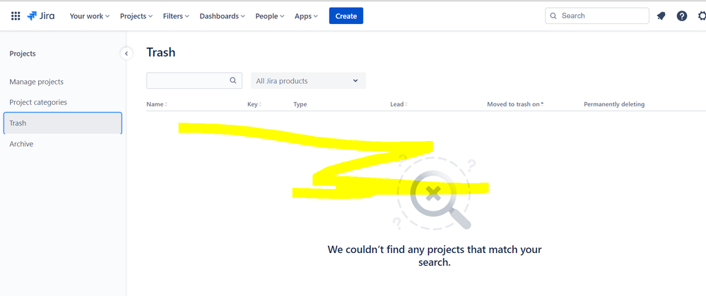

Sreenadh
November 21, 2022
Hi,
I have checked in the Trash as well but still i am not having the option to delete the same.
Please find the attached screenshots.
