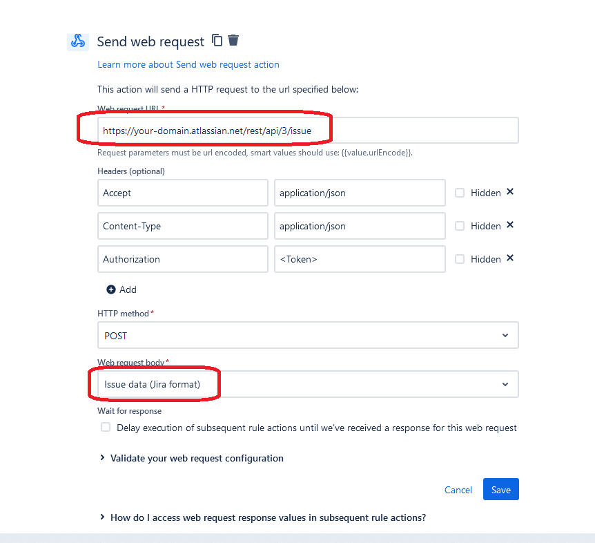

If it's in a different site, then Jira API should be the approach I'd take. You can use the create Issue API and pass all the info in the body from the original issues content.

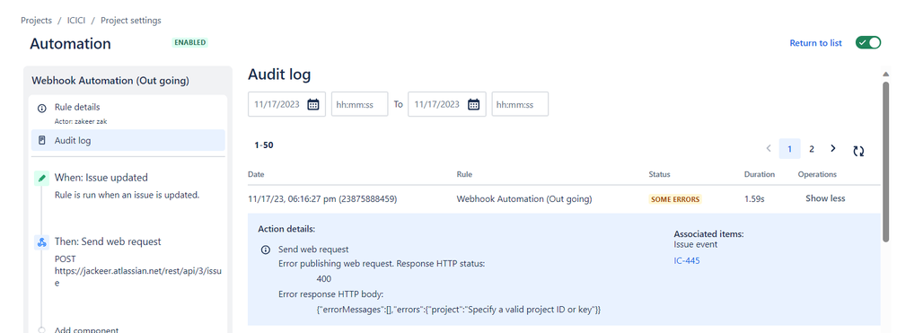

Jakeer
November 17, 2023
Hi @Jehan Bhathena
Thanks for the Automation rule.
When I tried the same way, I am getting below errors. Which format do we specify a key, I have tried adding {{issue.key}} at the end of the URL Was still getting 404 Error.
Please help me on this.

Hey @Jakeer ,
I tested this at my end and it seems that you will have to use the "Custom Data" instead.
To get the data required to pass in the custom data you can use this API : https://developer.atlassian.com/cloud/jira/platform/rest/v3/api-group-issues/#api-rest-api-3-issue-createmeta-get. Eg. https://<sitename>atlassian.net/rest/api/3/issue/createmeta?projectKeys=<projectKey>&expand=projects.issuetypes.fields .
The output from the above API can be used identify the fields and parameters needed for issue creation, you can then pass the formatted values in the Custom Data.

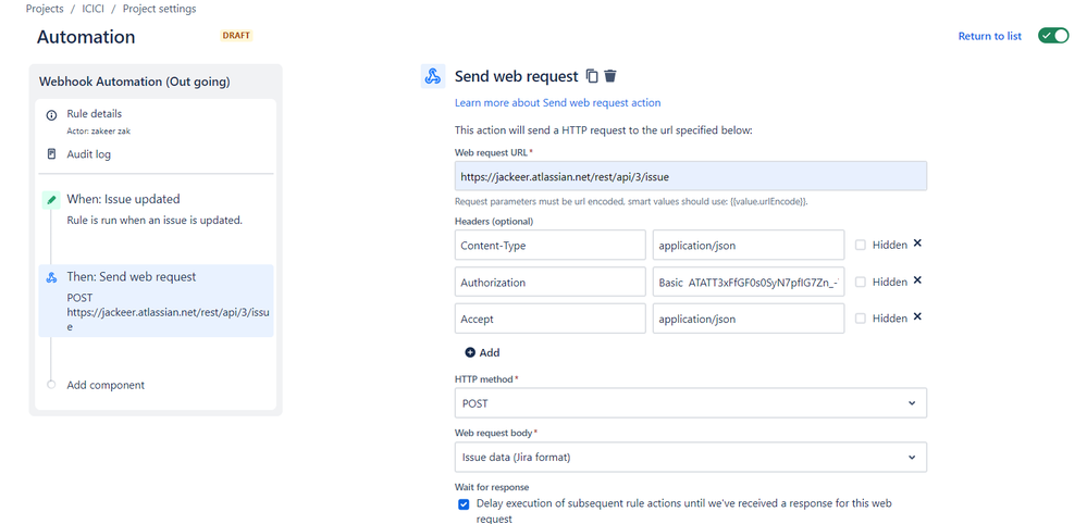

Jakeer
November 20, 2023

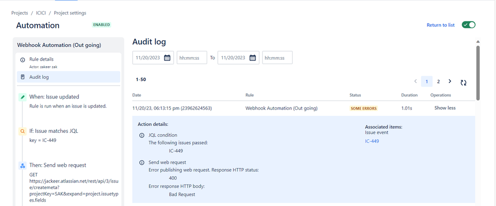

Hi @Jehan Bhathena
I have tried the same way you mentioned, but unfortunately, I am getting the errors.
Attaching the Automation Rule screenshot.

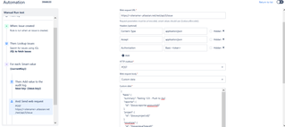

Jehan Bhathena
November 20, 2023
Hi @Jakeer ,
The createmeta API call that you're using seems to have some issue.
I will recommend the below algo for the automation that you're creating:
  • TRIGGER: Based on when you want the issue to get replicated
  • CONDITION: Filter only the issue/s that you need
  • ACTION: LookUpIssues that you need to pass to the conditional loop
  • Advanced FOR, where the above issues need to be piped
    • Log issue key to verify if the correct key is used
    • WebRequest
Adding the body of the webrequest:
"fields": {
"summary": "Testing 123 - Push to Jira",
"reporter": {
"id": "{{issue.reporter.accountId}}"
"project": {
"id": "{{issue.project.id}}"
"issuetype": {
"id": "{{issue.issueType.id}}"
"description": {
"version": 1,
"type": "doc",
"content": [
"type": "paragraph",
"content": [
"type": "text",
"text": "{{#jsonEncode}}{{issue.description}}{{/}}{{issue.description.jsonEncode}}"
To verify if the webRequest works you need to use the below validator:
I would recommend you go thru the smart values documentation here to get a better grasp on the Automation and what it can provide. https://support.atlassian.com/cloud-automation/docs/smart-values-in-jira-automation/
I cannot share a export of the automation at my end since it has content that can identify my site's UUID.
Jira also offers a great set of templates https://www.atlassian.com/software/jira/automation-template-library, you can use these to practice the automations too.
Hope this helps.

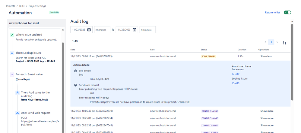

Jakeer
November 21, 2023
Hai @Jehan Bhathena
Thank you so much for your help.
But unfortunately, I am getting error although I followed all the steps you have provided to me.
Jehan Bhathena
November 21, 2023
Hey @Jakeer ,
The user whose token you've used here doesn't seem to have Create Issue permissions. Can you verify if that can be changed and then retry?

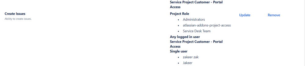

Jakeer
November 21, 2023
Hi @Jehan Bhathena
FYI, Both the instances belong to me, and I am having all the access and Create Issue Permission in both the instances.
AttachingPermission.png you the permission level screenshot with you
Thanks,
Jehan Bhathena
November 21, 2023
Hey @Jakeer ,
The POST request needs a Auth token, this token (to which ever user it belong) doesn't have access to create an issue. If you created a token previously I'd suggest creating a new one and retrying.
The above error is for permissions and more details can be found here: https://community.atlassian.com/t5/Jira-questions/quot-errorMessages-quot-quot-You-do-not-have-permission-to/qaq-p/2007900
PS: Google search the error and you'll come across the same solution of checking the permissions.
Would recommend you check this on some tool like POSTMAN or curl to verify everything works and then move towards Jira Automation since it's easier to debug on API tools. :-)
