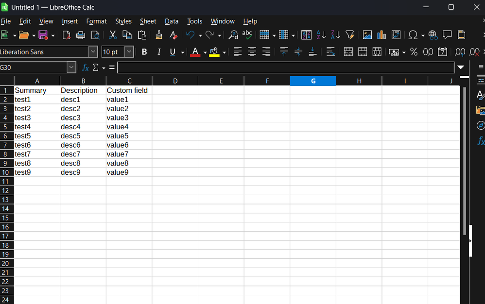

Step 1: Prepare Your CSV File
First, create a CSV file with three columns: Summary, Description, and the Custom Field that you want to update. Here’s what to include:
  • Summary: Add dummy values (e.g., "Dummy Summary 1", "Dummy Summary 2").
  • Description: Add dummy values (e.g., "Dummy Description 1", "Dummy Description 2").
  • Custom Field: Add all the values you need to update in Jira.
Ensure the file is saved in CSV UTF-8 format.

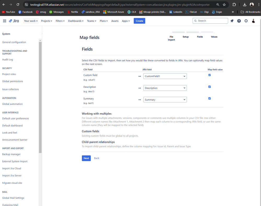

  3. Map the Fields:
    • Select the dummy project created earlier.
    • Map the fields from your CSV file to Jira fields as follows:
      • Summary: Map to Summary
      • Description: Map to Description
      • Custom Field: Map to the specific Custom Field you are updating2.png

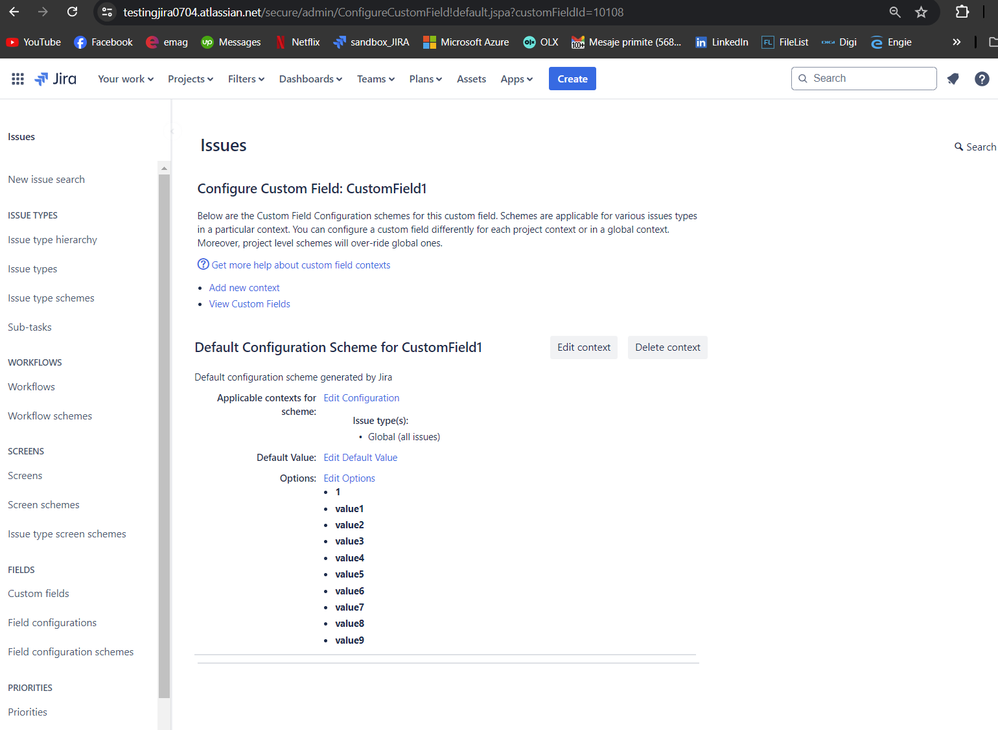

  • Complete the Import: Proceed with the import and verify that the values have been updated in the dummy project.3.png
