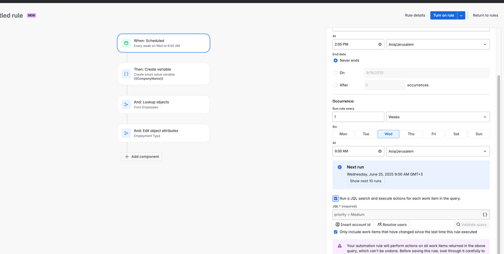

See this simple automation:
First:
set the JQL to one work-item like: Key = "WORK ITEM KEY", if it works, set a general JQL for all the work-items you want.

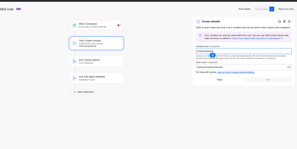

Second:
Create a Var to fetch the Company Name

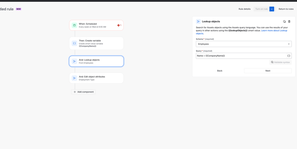

Third:
Fetch the object to a var

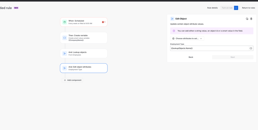

Forth:
set the object in the CF of the issue
Hope that helps.
Ariel.
