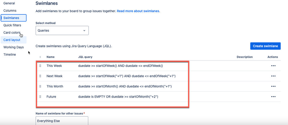

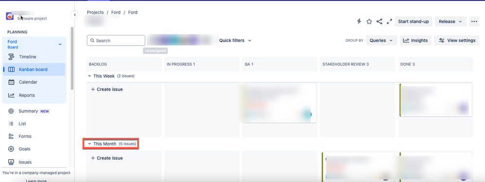

Currently, the swimlane for This Month shows tickets that have a due date in future months.
Can I adjust the JQL for the Future swimlane to hold the tickets that are beyond the next month + duedate empty?

Hello @Youmna Alomari
The JQL to satisfy that requirement would be:
duedate is empty or duedate >= startOfMonth(+2)
If the current month is June then startOfMonth() = June 1
If the current month is June then startOfMonth(+1) = July 1
If the current month is June then startOfMonth(+2) = August 1

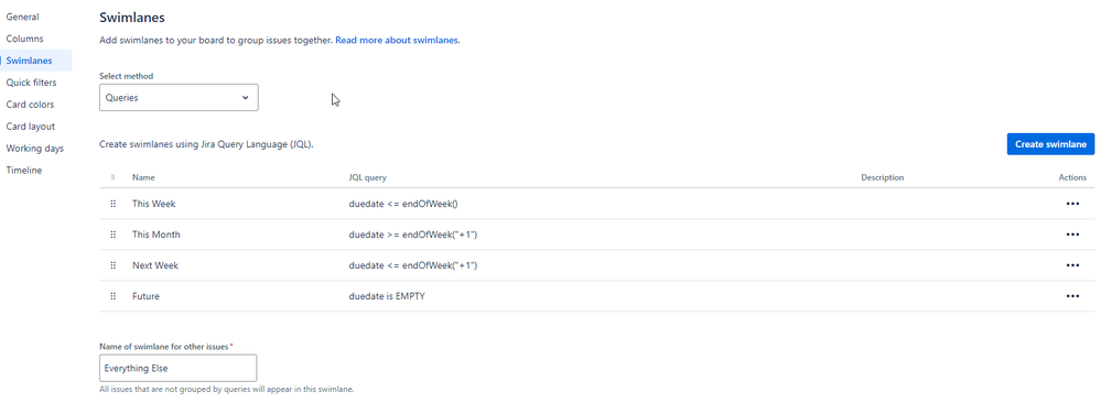

Duc Thang TRAN
June 13, 2024
I just want to add my opinion about your existing swimlanes:
  • this week: duedate <= endofweek(): This will take all tickets due in the past, including last week. it shoul be duedate >= startofweek() and duedate <= endofweek()
  • this month: duedate >= endofweek(+1): This will take all tickets due from June 23rd, 2026 onwards. It doesn't make sense. It shoul be duedate >= startofmonth() and duedate <= endofmonth()
  • next week: duedate <= endofweek(+1): This will take all tickets due in the past, including this week. it shoul be : duedate >= startofweek(+1) and duedate <= endofweek(+1)

Duc Thang TRAN
June 15, 2024
it correcte your jql for next month , and for  all issues that don't meet your JQL due date, you will find them in the "Everything else" lane.
and for your last question :
A swimlane is a horizontal categorization of issues, not for completed or uncompleted issues. Here a exemple
If you don't see few completed issue ,your need control  your configuration of the board to show completed issues.
