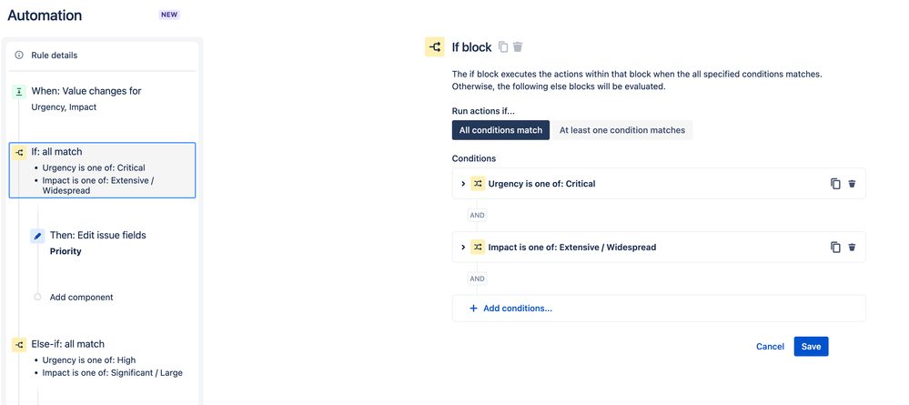

Your automation rule should simply use some elifs.
For the rule:
  1. start with a "field value changed" trigger on your urgency and impact fields.
  2. Add a condition -> if / else block
    1. add 2 conditions and check "all conditions match"
    2. use 2 issue field conditions and match your urgency and impact
    3. add an action "edit issue" and set the respective priority
  3. Repeat for all your different priorities.
It should look something like this:
Hope this helps!

Thanks Tessa, it helps a little to understand how it can be done. Unfortunately, it doesn't seem to work. It appears to take the first condition and set the priority to Critical, even though the Urgency is another state.
Question? Why did you choose "is one of" and not choose "equal".
Following your recommendation, (hope I am correct), I will need to do this for every sector of my Priority Table and make a long set of rules to match - so in my table has an Impact of Critical with a Urgency of Low = Medium (an impossible scenario really, but it is in the table like that). then I will need to make rules for all scenarios of the table. Correct?

To answer the questions:
- Yes, you would have to make an if block in the same rule for every possible combination (you mention that it is an impossible scenario, but often Impact and severity is used, and then a global impact with minimal severity, or indivudual impact with blocking severity is possible).
- "One of" instead of "equal" makes it possible to add multiple values, but if you use only 1 value, equal works fine too
- You don't need to add something in your workflows, it all depends on your trigger.
