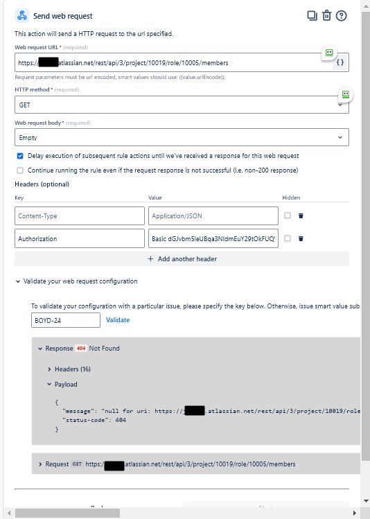

I am trying to build what I thought would be a simple automation rule with a web request to obtain the email addresses of the members of a project role (to be used in a later step of the same rule to send that group an email message). Nothing I try works and I have been unable to find the resolution through my own research, so I am hopeful that someone here has experienced the issue and can provide guidance.
I have formatted the request as follows:
URL: https://<OURCOMPANY>.atlassian.net/rest/api/3/project/10019/role/10005/members
Method: GET
Body: {} Empty
Delay execution: Checked
Header: Content-Type = application/json
However, when I provide an issue key from that project and attempt the validate button, it fails with a 404 not found Response and tells me the fist one below in the Response Payload:
If I take the "members" off the end and try, it, it tells me the project is not found, but I know for a fact that I am using the proper project id and role id, which I've shown as the second one below.
(* NOTE - I also tried both versions using project key instead of project id, but that gives the same results.)
  "message": "null for uri: https://jkseva.atlassian.net/rest/api/3/project/10019/role/10005/members",
  "status-code": 404
  "errorMessages": [
    "No project could be found with id '10019'."
  "errors": {}

I tried this though, but am still getting a 404 error. Any further suggestions? Thanks.image.png

Cool I see the issue here with that screenshot! I should have asked for one earlier.
  1. You need to type in the Key/Value for every header, including the Content-Type, so make sure you have:
    1. Key: Content-Type
    2. Value: application/json
      1. It won't accept capitalized like in the example

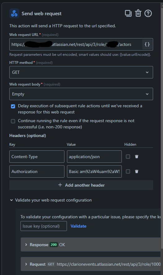

See below a screenshot of my config working with appropriate authorization & content-type headers:

Thanks again for all your guidance. When I use the url: https://xyz.atlassian.net/rest/api/3/role/10005/actors, I get a successful response, with a payload of actors, but no actual actors are listed:
  "actors": []
When I use the full url you provided previously, it still gives me a 404 (https://developer.atlassian.com/cloud/jira/platform/rest/v3/api-group-project-role-actors/#api-rest-api-3-role-id-actors-get), but I am pretty sure that is because I am supossed to modify the part of the string following the "/rest/v3" with different text specifying my distinct values, but no iteration of that that I have tried works.
So, if I have the basic "actors" call working (but with empty results), what do I now need to change in order to further designate the specific project for which I want to identify the actors associated with that project role?

Jovin
July 1, 2024
Hey @Tim Bonney
On the right track! That URL that gives you no actors is the correct usage, glad we got it authenticated and working. That other URL I provided was simply the documentation so you're on the right track here.
I was off-track though; I gave you the find default actors for the project role, my bad! The correct one you want would be: https://developer.atlassian.com/cloud/jira/platform/rest/v3/api-group-project-roles/#api-rest-api-3-project-projectidorkey-role-id-get
You just need to change your URL that you're point to in your automation to:
/rest/api/3/project/{projectIdOrKey}/role/{id}
The automation I suggested to iterate over the data would need tweaking to get where you want, but should help provide some basic sguidance!
Tim Bonney
July 1, 2024
Thanks again @Jovin
Looks like it was the "/members/" on the tail of my url string that was causing issues.
Now, I'll need to work on the parsing as you suggested, but I may need additional call(s) first because the actor content returned does not include email address.

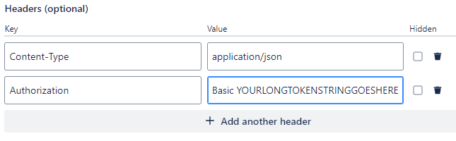

@Rupa Goyal is correct, you need to create an API key and then encode it as Base64. If you're windows based like me you can follow these:
$Text = "email:token"
$Bytes = [System.Text.Encoding]::UTF8.GetBytes($Text)
$EncodedText = [Convert]::ToBase64String($Bytes)
$EncodedText
  •  Copy that text that is output and put it into one of the headers in your automation, so you headers should be:
    • Content-Type
      • application/json
    • Authorization
      • Basic BASE64TOKEN
Hopefully that helps!

Jovin
June 28, 2024
No worries at all, @Tim Bonney , it gave me headaches when I started with APIs too!
So, the API generation is done via the instructions and that's on your Cloud instance. You copy down that API token and do the PowerShell part on your local machine, if you don't have PowerShell, you could try find alternatives for macOS or others by googling "how to encode string as base64".
I wouldn't recommend doing an online tool for it just in case there's a possible security issue!
Then you can input that information into your automation rule, see an example screenshot below:
