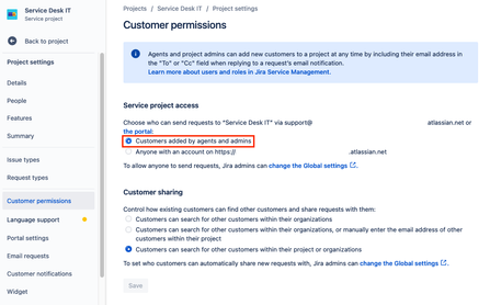

In Jira Service Management, there are only two options when it comes to customer permissions.
For customers to not be added automatically on all projects, it’s necessary to go to Project settings > Customer permissions (company-managed projects) or Project settings > Channels > Customer permissions (team-managed projects).
On this page, it’s necessary to change the “Service project access” to “Customers added by agents and admins” > Save.
Once you change this setting, customers will be removed from the project if they weren't manually added previously by an admin/agent.
Hope this helps!

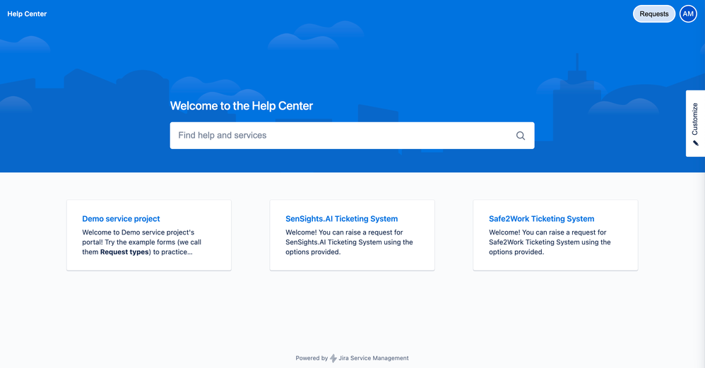

So to test this out, I've added a dummy customer to only one of my projects and the other project has no customers at all. I'd expect that the dummy customer should be able to view only the project they were added to. However, this is not the case. When I access the help centre using the dummy customer account, both the projects are visible.
Please guide me how only one project would be visible in the help centre for the customer? I wouldn't want to disclose all my projects to different customers that do not need to have visibility to those projects.
Here is a screenshot of the help centre page:
Note: The two projects I am concerned about are: SenSights.AI Ticketing System and Safe2Work Ticketing System.

Thank you for the details and screenshots, Anas.
I believe you are using your administrator account on the portal and not the dummy customer account. I say this because the avatar on the top right is the same as your account here in community and also there is the option “Customize” on the right side and only admins can customize the portal.
Can you please use incognito mode to access the portal with the customer account?

Anas Magi July 14, 2021
Thanks Angélica, your feedback was helpful. I didn't realize that I was using the same account to access the portal. Using the incognito mode helped.

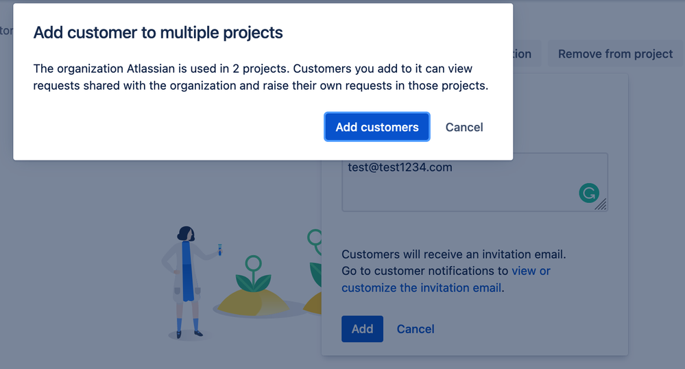

I still am facing the same issue. I've added the same organization to both the projects and then added a customer to only one of the project. The customer automatically gets added to the other project as well. I need the customer to be available only under the single project that I've added them in. Looks like JIRA replicates the customer under both projects automatically.
How do I make sure that the customer remains in under a single project / organization and doesn't get replicated in the other project?
Dirk Ronsmans
July 14, 2021
Isn’t that a side effect of the organisation? Same organisation so even if u add it once it becomes part of all?
if that’s correct behaviour I’m not sure..
Like # people like this
Angélica Luz
July 15, 2021
Hi Anas,
It happens due to what Dirk mentioned.
When an organization is added to multiple projects, all customers that are under the org will also be added to the project.
When adding a new customer to an organization that is shared between projects, this message appears:
With this said, it would be important to create organizations with different names on each project, otherwise, customers will be automatically added to the projects.
