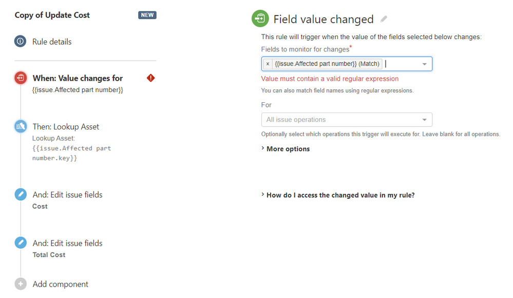

I am creating automation that is to be triggered by a field value change and the field I want monitor for changes is not listed in the drop-down.  So, I am trying to use the smart value for the field (e.g. {{issue.Affected part number}} but I am getting a "Value must contain a valid regular expression." error when I try to publish the automation.  Could the issue be because the data in the field is an Asset?  If so, is there a workaround?
I can't post an Audit Log because I can't publish the rule due the error.  Basically, what I am trying to do when the value in the Custom Field "Affected part number" changes I want to look up the key for the asset value in the field and update Cost field with cost associated with the asset (using {{lookupAsset.attributes.cost}}) and the Total Cost (using {{lookupAsset.attributes.cost}}*{{issue.Number of Units}}).  When field is initially populated everything work as it should, but if the wrong PN was entered and we edit record to change the value the Cost field would not update with the cost of the new item.  I created a manually triggered automation, and everything would update as expected but I would like to make the automation trigger automatically after the field value changes.

Dave Stillwell
October 25, 2024
I changed the field name to the cf number (e.g. cf[12345]) and I was able to publish the rule and based on link you provided I seemed to have been able to fluke into the solution.  I haven't gotten any feedback from my users if it is working as expected, so only time will tell (can't test in test environment since it is a bit behind the production environment)
