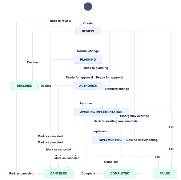

If you are using the default workflow for changes you will see that there are three transitions available depending on what type of change it is. Normal change is the one that you want to use if you want to have someone approve it before the change is implemented. This will move it to planning and then when you are ready you can move it to Authorize which requires an approver. All of these steps are manual unless you create automations for it.

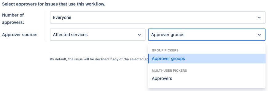

Forgot to add that by default the approvers are populated based on the service that has been selected to be affected by the change. If you do not use services you would have to change the Authorize status so that the Approvers field is used instead, that way you can control how approves it.

Thank you! The issue I am seeing on my end is that I don't see any options to actually move the Change to an approved state. Do I have to add an approver group manually to each change? Is there a way to simply set a default change approver group in the service management project and then that group will automatically get alerted when a change is requiring approval?

What type of change is it? Where in the workflow are you? If you selected Standard change or Emergency change it will move the change to Awaiting implementation, but if you used the Normal change transition it will end up in the Review status.
You would have to create a service and add the approver group if you have not changed the Authorize step to use a Jira field and Approvers instead.
Yes, you can set a default Approvers group, just go to Project settings > Request types > Changes and add the Approvers group to the request form, hide it and set the default group. The other option would be to use automation to set the default group.
What will happen when the change moves to Authorize is that an email will be sent to each approver, if there are no approvers that email will sent as soon as you set the approvers.
