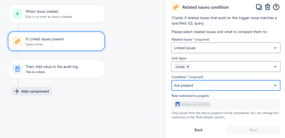

When you clone an issue it will allways create an issue link to the source issue, hence you shold be able to use an automation rule with a Created trigger, and then add a filter looking for the Clones link type.
This will not work using an Edited trigger since the link might have been removed by a user. But when the issue is created the link exists, and can be used as a filter for further processing in the automation rule.
Below the filter within you rule you can then set or remove values from all wanted fields.

@Gary Pallas, I created a test rule looking like this:

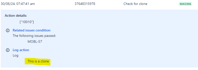

After I cloned a test issue, the audit log shows this::
Have you tried a setup like the example above?

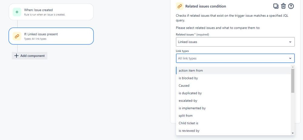

Thanks again Tim - yes I tried exactly that rule from your screenshot above and I don't appear to have an option for 'clones' within Link Types drop down. Was this a relationship type that was configured as a pre-cursor? Or was this out of the box? I can look to the JQL as another idea so again thanks for sharing that - appreciated.
There are a few additional options here but clones is not one of them

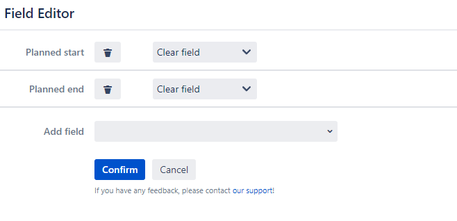

If you are having trouble achieving your goal with Jira Automations, you could try our app Deep Clone for Jira. Deep Clone allows you to clone issues and make changes to the data that is being cloned. You can use the Field Editor feature to edit field values or clear them.
When you're doing cloning action try to set planned start and end to empty value
