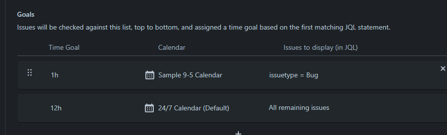

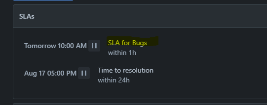

John Jos
August 14, 2023
Hi Esteban - I am not sure if this is what you meant but here is what I did: I created a new SLA and named it 'SLA for Bugs' with the condition that it will start once it's 'In Progress'.
But for some reason, there are 2 SLAs (please see attached). One SLA for Bugs as it should be and the other one is from the existing SLA with the goal for 'All Remaining Issues'. This cannot be edited. How do I get this to go and see only SLA for Bugs?Screenshot 2023-08-14 193329.pngScreenshot 2023-08-14 192526.pngScreenshot 2023-08-14 192424.png

Esteban Diaz
August 14, 2023
Hi @John Jos ,
I guess that I know what the problem is....
The thing is that when you create a SLA, your are actually creating a new custom field... and you must have both SLA fields in the same screen.
Yo can solve it ... creating a different screen for Bugs and include only the SLA for bugs on it.

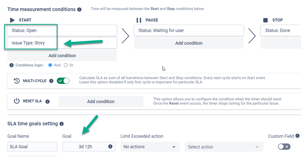

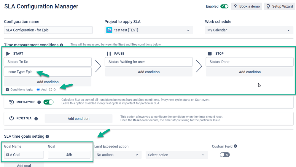

I think the following has already been recommended to you, but you should create separate SLAs with different issues as conditions for Start.
I will show how to set this in the SLA Time and Report for Jira add-on, which you can try with a 30-day trial.
For the Start condition of each of the SLAs, choose one type of issue and the required statuses (To Do or Open). Set the SLA goal of one SLA to 48 hours and the other to 72.
Save all SLAs, and it will work without crossing or starting on the same tasks.
My team developed this add-on, so if you need further help, please don't hesitate to ask.
