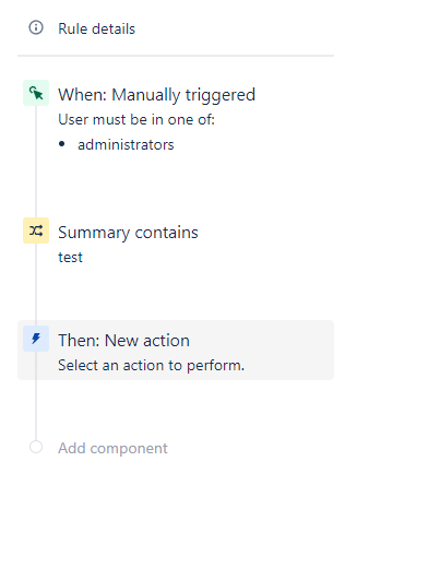

Hi @SAFE Customer Support ,
Can you provide more details (example) on the other field to be checked?
Which should the outcome be after the conditions are met?
Something like below is a start

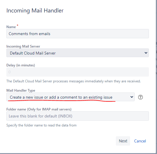

Hi @Sam Bartolome - thanks for looking at this.
Basically, the customer logs a ticket by email and uses a reference number in their summary. They are then sending update emails to the atlassian address and this is creating new tickets instead of updating the old ones.
I need to create a rule to check the email's summary against either the existing ticket summaries OR the customer reference field and put the update on the existing ticket instead of opening a new one.
If that isn't possible, then checking the new ticket against all the other and linking and closing it as a duplicate would be ok - not ideal but better than lots of open tickets.
Hope that makes sense?
Lucy
Sam Bartolome
April 8, 2022
You should be able to change the setting on the mail handler (Incoming mail).
In this case there is no need of automation and the mail handler will do all the job, creating a ticket or adding the comment to an existing ticket
April 8, 2022
Oh, that's great, i've set that up and i'll see how it goes - thank you :)
