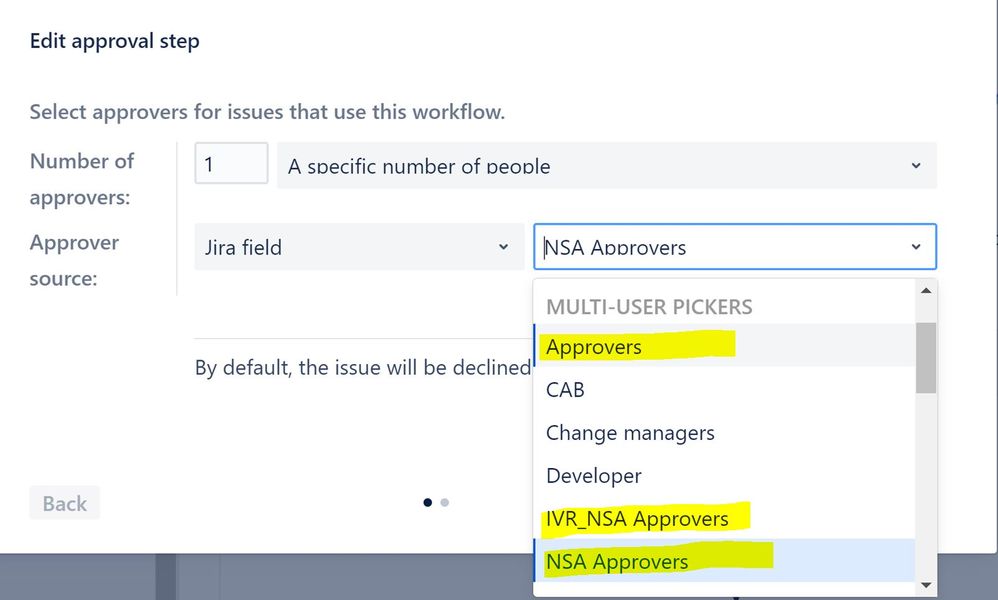

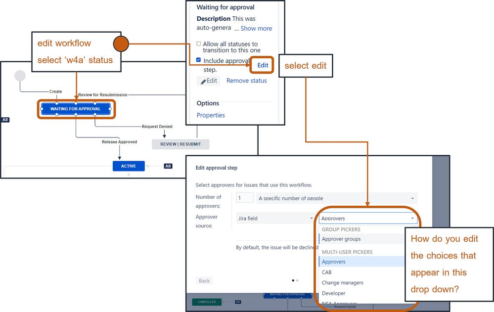

I have built out an automated process for approval of change management requests.  I need to split off a sub-set based on custom issue types.  I have built a custom field mirroring the OOTB "Approvers" field, e.g., "NSA Approvers", edited custom screens, etc. BUT - I cannot seem to figure out how to edit the available options when configuring the workflow / approval step - see image.  Thanks in advance. Hoping this is something simple I have overlooked.

I created a sister custom field ("NSA Approvers") with the same parameters to be used for a subset of issue types (e.g., another group of approvers).  I've gone through the config of the custom field, screen, etc., etc.  If I go to the workflow to edit (image) and change the 'approval step' accordingly, I don't see the option I am looking for, nor can I find, where to expand that drop down list with additional choices.

Long story short - I figured it out.  End to end process below - the underlined item was the blocker:
  • Create a new issue type
  • Create / copy a new workflow aligned to the new issue type
  • Create a custom field (e.g., approvers)
  • Create a user group (name) that mirrored the custom field (Approvers + 2 others I created)
    • This provided the visibility of the groups within the (issuetype-based) workflow (editing the approval step) to set them to specific individual(s) as approvers by issue type
  • Edit the custom field context to align individual approver(s) with the project / issue types
  • Edit the request types within the project (field layout)
    • Designated approver field (by issue type) configured to use default(s) and be hidden from the portal
