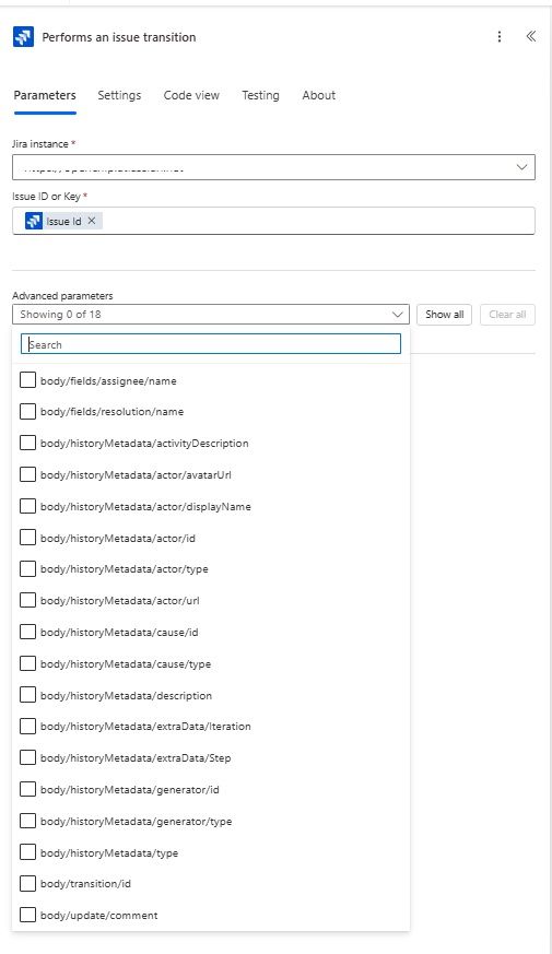

How do I transition the state of a JIRA issue within Power Automate? I've tried Edit Issue (v2) and Transition issue but I don't know how to fill in the fields.
I'm able to open a ticket with Create New Issue (v3) with Oauth and add comments with Add Comment (v2).
Thanks

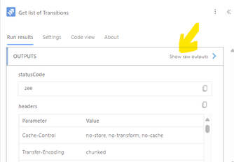

Figured it out.
I added a call to "Get list of Transitions" in Power Automate for the JIRA project and looked at the output to see the Transition IDs, e.g.
The ID codes are in the XML,
e.g.
"body": {
        "expand""transitions",
        "transitions": [
                "id": "151",
                "name""Done",
                "to": {
                "id": "171",
                "name""Rejected",
For my case, using "Performance and issue transition" I set the "body/transition/id" value to the number 151 to move the status to Done.
