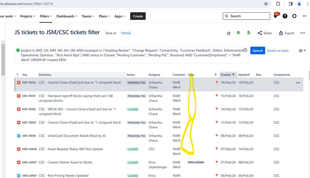

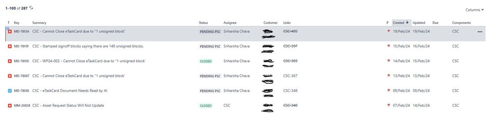

We are using JSM since recently and only agents has the access to the JSM tickets. We are also working with a development team which require having access to these tickets. We manage it by creating a clone on JS when we require their assistance.
Recently the dev team has the need to identify which JSM ticket correspond to a JS ticket.
I have tried using filters so they can see the correspondence but because they don't have access the the JSM project they cannot see the column links and identify the JSM ticket.
See screenshots below:
Example_issue_ticket correspondence_view authorized.JPGExample_issue_ticket correspondence_view unauthorized.jpg
Please let me know how the dev team can know which JS ticket corresponds to which to which JSM ticket.

Hi Coline,
That would need you to be adding a link when you are creating the clone, and giving your developers the permission to read the JSM project (you don't need to give them any more permission than just "browse project")
You might find it easier to use "create linked issue" rather than clone and move - that will automatically create a link from the JSM issue to the JS issue, as well as enabling automation to replicate actions from one to the other easily.

Ok, that depends on whether the project is company or team managed.
In a company-managed project, you need to go into the "permission scheme" for the project to check the project browse access, and possibly add a new role to it (only Jira admins can do this, not project admins).  I tend to have a global project role called "read only", and I then add "browse project: role: read-only" to most project permissions.  That enables the project admins to add people into the "read only" role when they want someone else to be able to read (but not do anything else)
In a team managed project, the project admins can go to project settings -> internal access, and add people into the built-in view-only role
If your developers have read access to the JSM project, you should see the links column filled with the links next time they visit your search!
