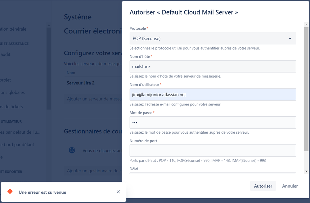

I deleted this server last week actually. Unfortunately, I was not able to reproduce the steps that led to this result. Sure enough, reading this bug report you directed me to, it wouldn't be possible for me to be able to remove the server from the list. I also tried to add the server with your method. However, when I try to add the server with your procedure, I get an error message. I joined a screenshot of the previously mentionned error.
The interface is in french, but its mostly the same. Is there anyway to see the error log ?
Thanks for helping me !

Hi @Karell ,
My mistake I looked at the settings again and I had crossed some details from the Workaround noted in the BUG's workaround with new settings and you need to have the option following options updated:
  1. Hostname: Default Cloud Mail Server
  2. Manually set Timeout to 10000 rather than leaving it blank to go to the default
Regards,
Earl

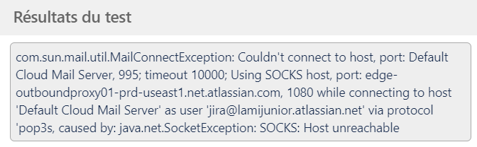

I tried the option you suggested and its still not working. When im creating my mail handler, and testing it, im getting this error message.

Hi @Karell ,
We will need to dig into this one in a bit more detail and see what is going on in the system back end,  as noted previously the option to delete the mail handler should not have been possible so it sounds like there is a new bug occurring here.
I created the following Support request on your behalf so we can get some additional details, and the Cloud support team will reach out shortly:
Please visit the link to access the support request and verify the case details are correct, and add in any additional details that you have on the scenario.
Regards,
Earl
