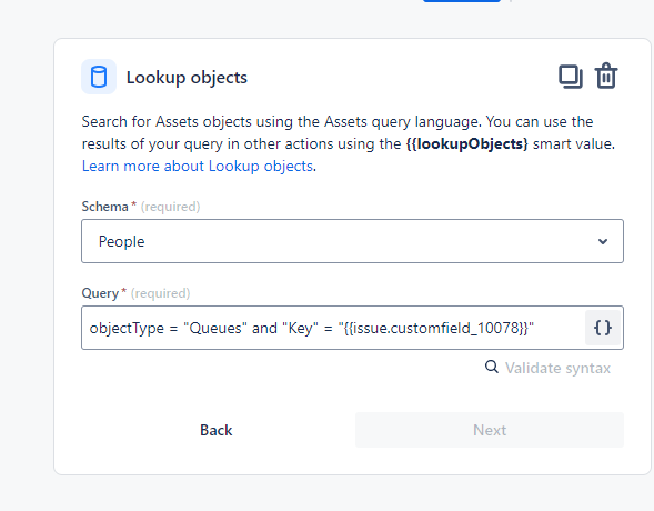

Yes, you do need to Lookup the object from Assets.
Inside Automation, there is a Lookup Objects command, that will Lookup the object from your schema.
Once you have done that, all the attributes for the Object will be available via
{{lookupObjects.<Attribute name>}}

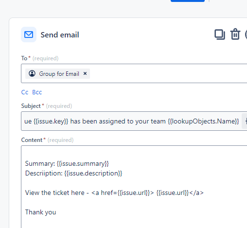

which you can place inside your send email request.

Tim Kennett
August 11, 2024
Mark SPOT ON!!!!
Thank you for your example!!!!! I can't thank you enough. Its been a thorn in my side for a couple of days now.
I was on the right track but just needed a GREAT example like yours.
Thanks again!!!!!!
Tim
