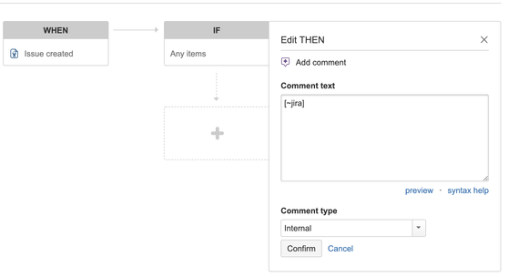

Option 2:
Consider using the automation functionality to trigger email sending.
  1. Go to Project Setting > Automation page.
  2. Create a custom Automation.
  3. When - Issue Created.
  4. If - Any (You can configure this with JQLs to be triggered when the condition is true).
  5. Then - Add comment (in the body, have a mention to you all that a ticket was created - Make sure this is an internal comment).
The above should help you achieve this.
Hope this helps.
Ismael Jimoh
July 23, 2019
Screenshot 2019-07-23 at 22.52.37.pngSee above image on how to perform option 2.

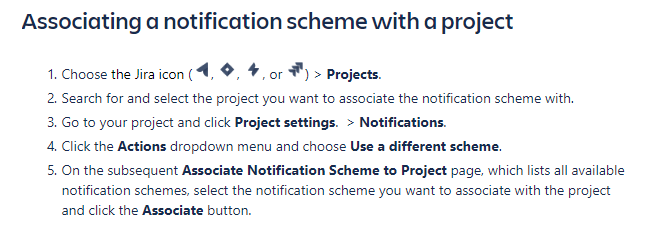

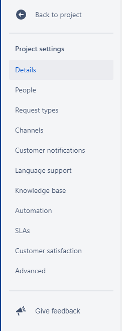

Also how do you assign a notification scheme to a project? Below are the instructions from the Atlassian documentation found on this page:
https://confluence.atlassian.com/adminjiracloud/creating-a-notification-scheme-776636401.html
However I don't see the "Notifications" option in my project settings
