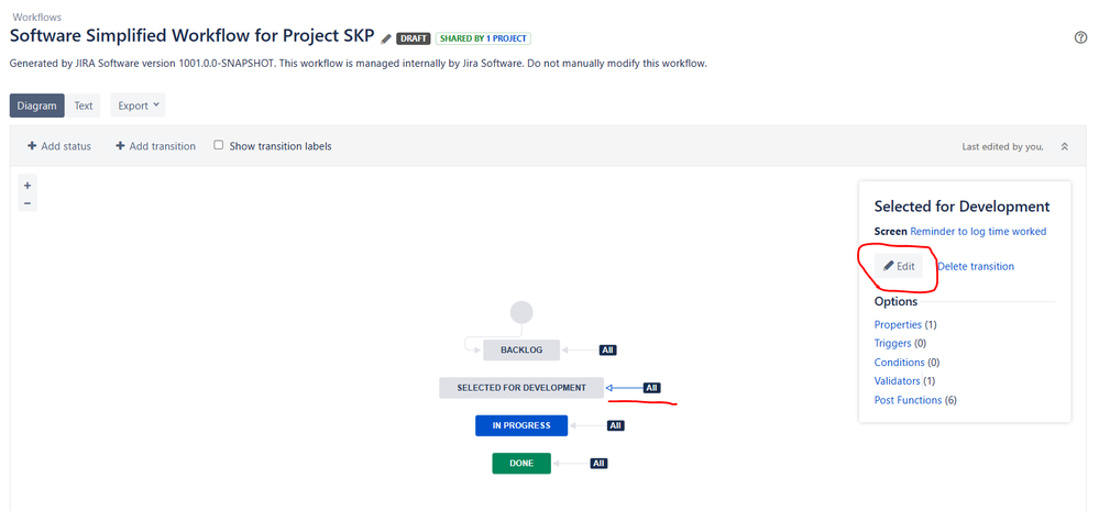

Next, in the workflow for the issue where you want to implement this, add the screen to the transition where it should be effective, like this -

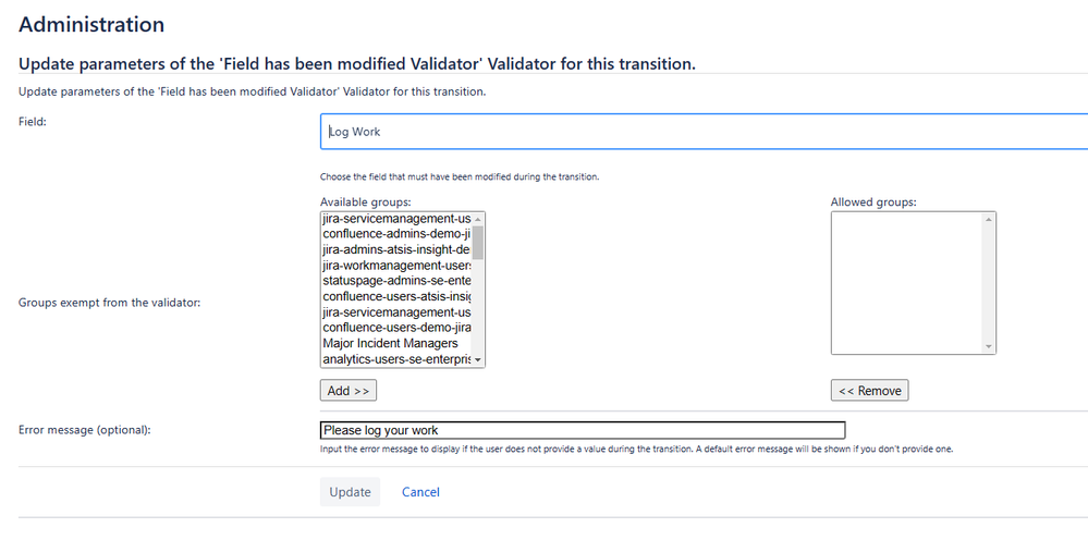

Next, you will need to add a validator. This is what enforces that something has been logged.

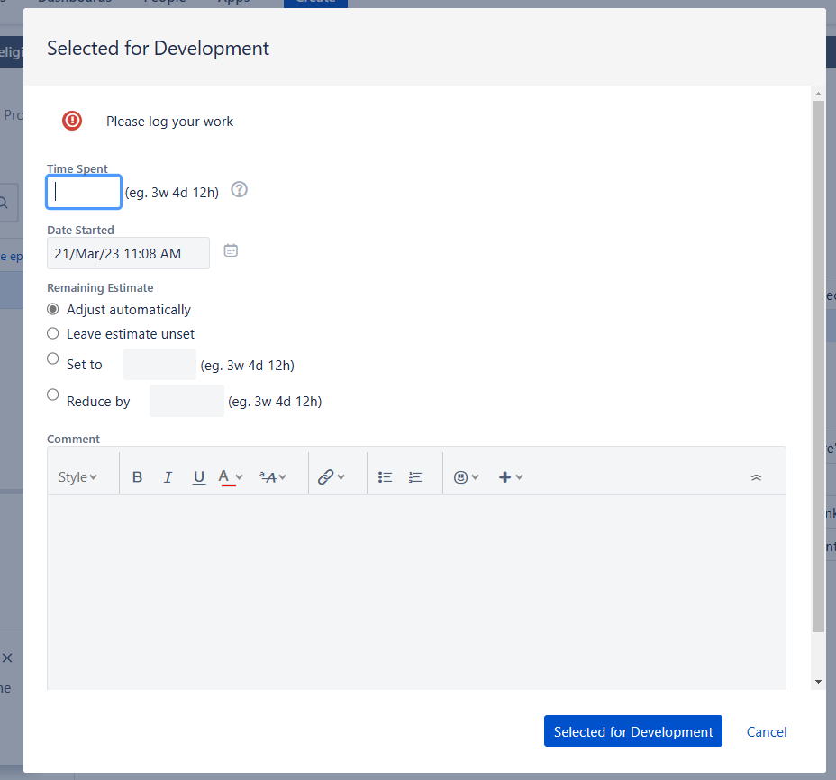

The end result is this, when I try to transition from the Backlog status to Selected for Development -

I went ahead and started following the provided steps, however the second step does not seem to be available on my end.
https://community.atlassian.com/t5/image/serverpage/image-id/246739i964000813F0991A9/image-size/large?v=v2&px=999
I have admin rights in Jira, but I am not seeing the Edit button as in the screenshot. Can you please elaborate a bit more on where I need to go to be able to access it?

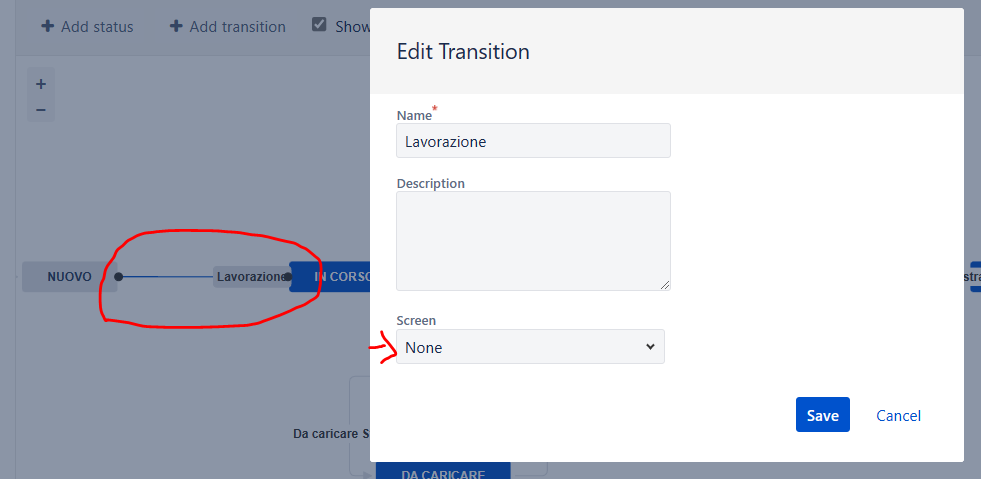

Here is another workflow. If I double-click on the transition from Nuovo / new to In Corso / in progress, this screen pops up where I can add the screen, which should be shown on the transition. Then, if I hit Save and publish the workflow, the screen should be shown when I try to go from Nuovo to In Corso in a project / issue where this workflow is active.
