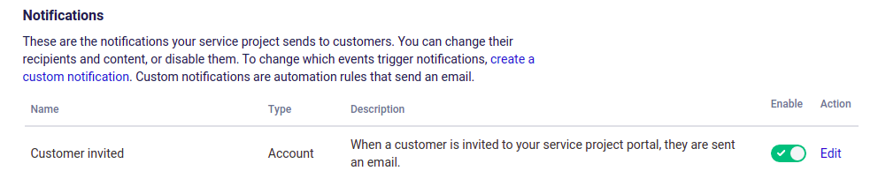

Thanks Hernan for your prompt reply. The issue I faced is that the user I added to the portal never received the enrollment email. I had to to go to the JIRA admin and set the password manually for that user.

Any chance that the notifications are disabled for that project or the outgoing mail isn't enabled at all?
First option is within the project settings on the Customer Notification section
Selection_293.pngSecond option is one of the main settings within the System settings that you can set as administrator
