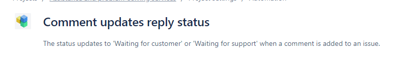

Hi @Jack Howard ,
Believe it or not but this is actually an out of the box (legacy) automation rule. So perhaps those are disabled or you cleaned them ?
Can you check under your automation rules (possibly under legacy automation) that there is no such rule disable?
In my out of the box instance this is the following:
If not, I can provide you with the details of the rule.

Thanks @Jack Brickey @Dirk Ronsmans I found this in Legacy Automation, not been in there before!
I found that it was erroring on the 'if issue matches....' and also on the 'then transition to...' steps.
Going to take some working out but will have to rebuild!

I have successfully done the rewrite, except now it shows in the activity history on each issue, that a user has made this change. Is that normal?
I have gone to options, 'run rule as', and then selected user who triggered rule.
I'm sure this wasn't how it ran before... I may be wrong.
Dirk Ronsmans
August 27, 2021
Hey @Jack Howard ,
thats all normal. A rule will always execute as a user. Either you can specify a user or like you did set it as the user who performed the action that triggered the rule.
