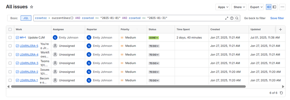

JQL has some limitations when it comes to date range filtering, particularly in combining multiple conditions simultaneously.
However, you can try to use such JQL queries in your case:
  • To get the list of issues that were created between two dates:
creator = currentUser() AND created >= "2025-01-01" AND created <= "2025-01-31"

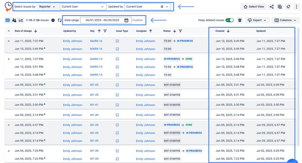

Additionally, you can try the Issue History for Jira app, which is provided by my team. Using it, you will be able to get the full change history and filter by:
  • User (who made the change)
  • Date range (between two dates)
  • Specific fields changed (such as status, assignee, updated, created, etc.).
With the help of the Issue History app, you can quickly check which issues you’ve created and updated within a specific date range, with no need to use JQL. For example:
Here’s a quick look at the app: Issue History for Jira on Atlassian Marketplace.

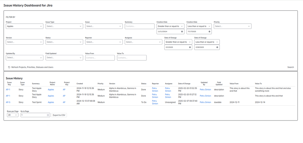

July 17, 2025
Hi pvala@micron.com ,
If you are open to using apps you can use  Issue History Dashboard for Jira (Work Item History) , an app released by our company.
You can filter by Creation Date from and to and Date of Change from to and export your result to CSV.
Regards,
Petru
