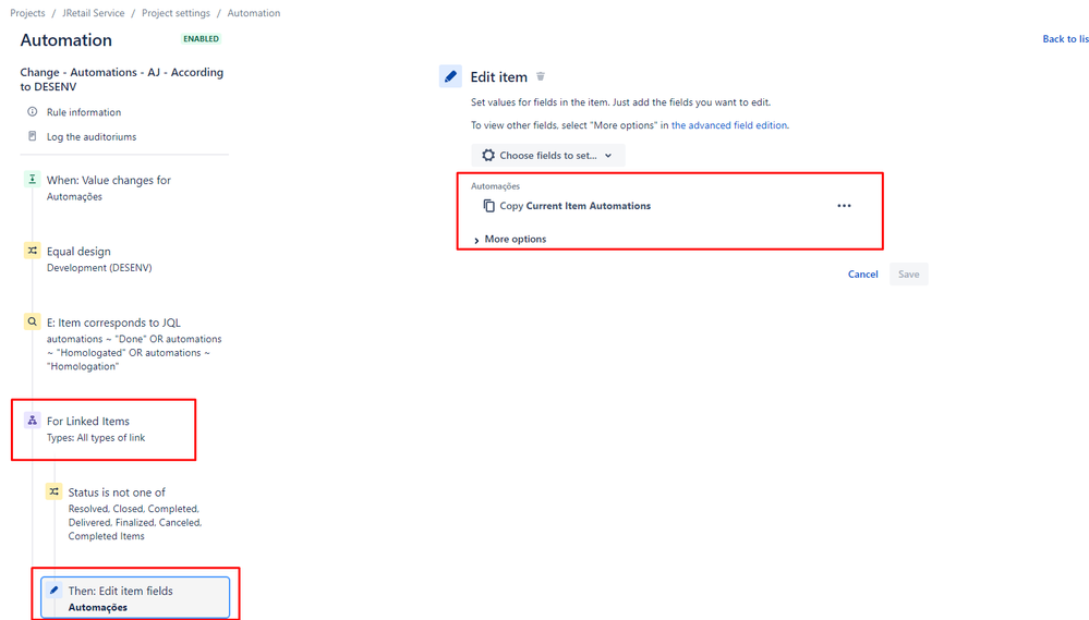

So I'am trying to make an automation that changes an field based on another iten field from another project, but to change the itens field I need to use a branch, and when the edit iten automation tries copying the current iten field it actualy dont't copy the linked item fiel but it owns so it don't change a thing.
I tried to explain it but it's very confusing, anyone can help me with that?Screenshot_4.png

To do this, you will need an automation for multiple projects / global automation.
For the multiple projects (Main and Secondary project), you will need to set the projects that will use this automation, then
  • Set the automation in the Main projetct
  • Previous conditions that you use
  • Branch Rule → Linked issues
    • Link types: Blocks, Clones, etc (all "Main" links to dependecies issues)
      • Action → Edit issue (select the field that you want and set to "Copy Values", and use "Trigger Issue")
