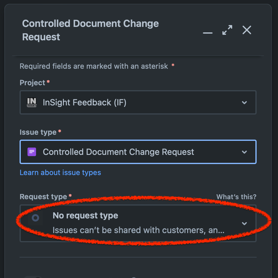

Tom Horton
February 22, 2024
@John Funk OK, I have the new workflow, I've assigned it to a new Issue Type. How do you assign an existing Request Type to this new Issue Type? I'm so close to getting this to work but I can't find the right place in my Service Project settings. Here's a screenshot of where I want to automatically assign a Request Type for the user.
