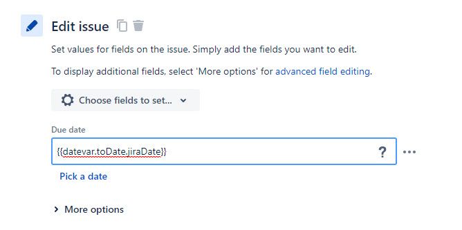

Looks like I didn't need the second variable, I just needed to add .toDate.jiraDate to my first create variable smart value as it was returned as a string. adding {{datevar.toDate.jiraDate}} converted the string to the correct usable jira date format.

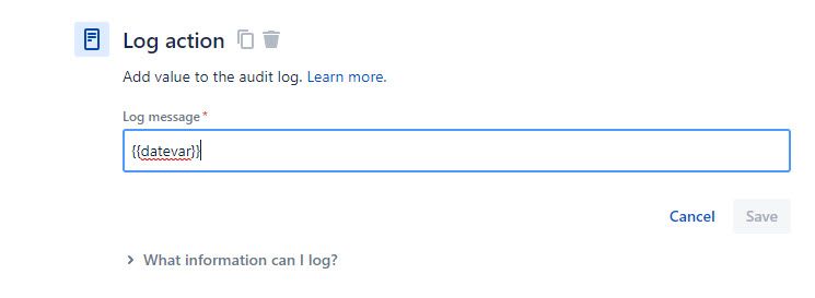

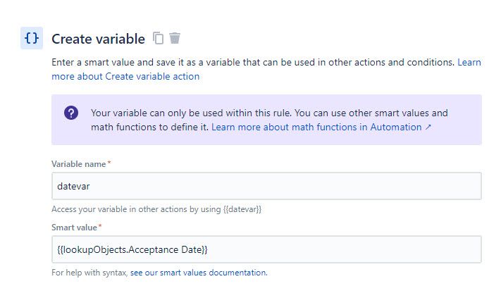

What I have done in my automation is create a variable called datevar to look up the attribute "Acceptance date"
I then create an audit log action to confirm the date is pulled from assets.

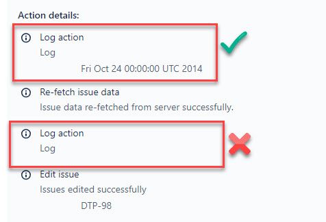

The audit log shows the datevar variable returns a date from assets as expected in the wrong Jira date format. datevartwo variable is empty so I can only assume Jira cannot convert the date format. This is where I am stuck.
Result of audit log below
As you can see the second log is empty
