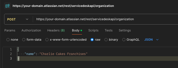

Your post call should go to rest/servicedeskapi/organization and then in your body you will add the data. Something like this in Postman:

@Mikael Sandberg I was able to fix the error I was getting - It was expecting for me to pass the Authorization token where I had it set to "Inherit from Parent" after I was doing a Get Organizations. After I changed the order of execution and added back the Authorization Token - I was able to get the Organization records created successfully - Thank you
