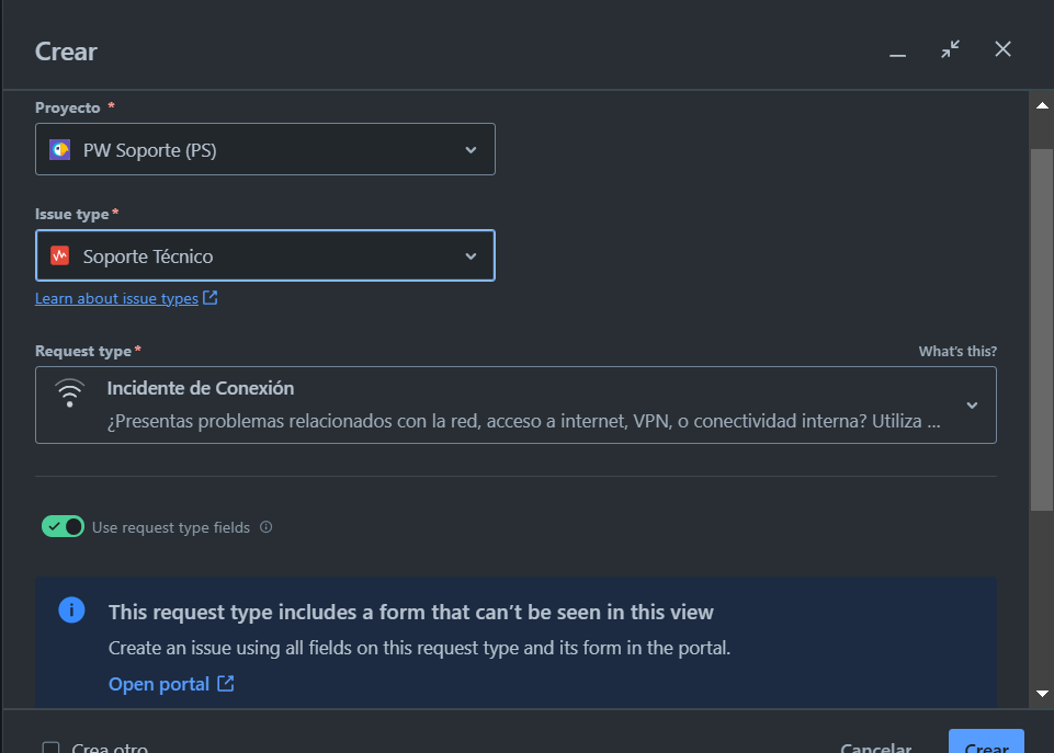

The issue you mentioned occurs because the Request Management section is not properly configured, where the request types offered by JSM are defined.
In this section, you can link request types such as incidents, problems, or changes to the created form. Then, when you generate a report from your project, you will see the following:

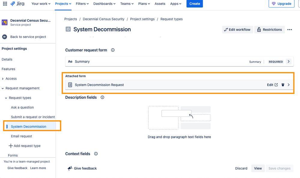

I have associated the Request Type "System Decommission" with the form "System Decommission Request" as shown below.

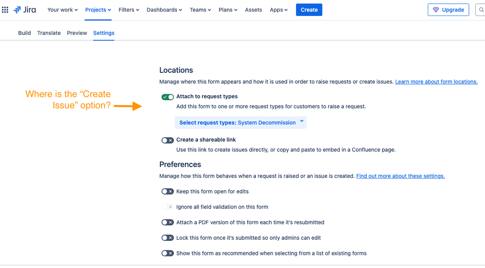

When I go to the "System Decommission Request" form settings, I still do not see "Create Issue" option.

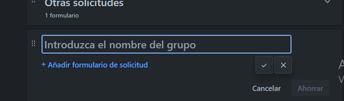

  6. Create a new group with the name of your choice.
Clarification:
The groups you create within the project can be named as you prefer. In my case, the names refer to the forms I’m trying to associate. A good practice, if it’s for a company and will be used internally, is to segment it by areas for better management of form visibility. If that’s not the case, I recommend organizing it by frequent types of requests that occur in your company, such as internet outages, etc.
Finally, what you’ll need to do is, within the created group, associate the form you're trying to have appear in the configuration.

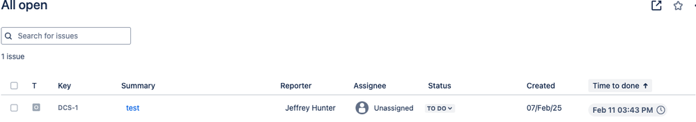

Ok, I think I may have misunderstood how JSM works.  So I have configured the request type and portal group as described and I do see a new JSM issue is created when I submit the form.
