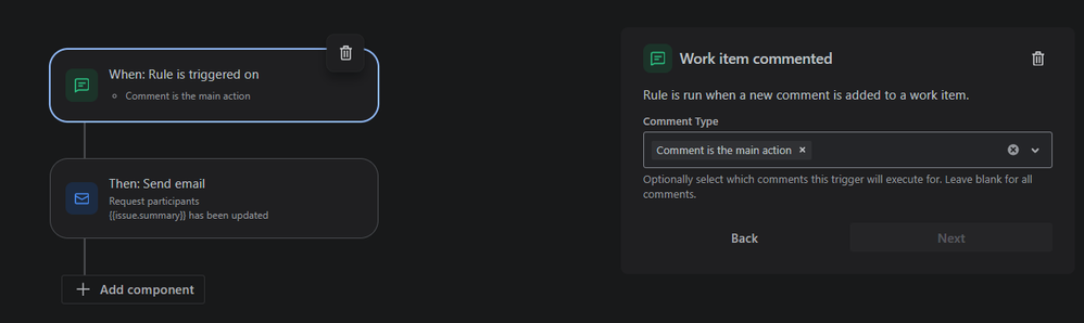

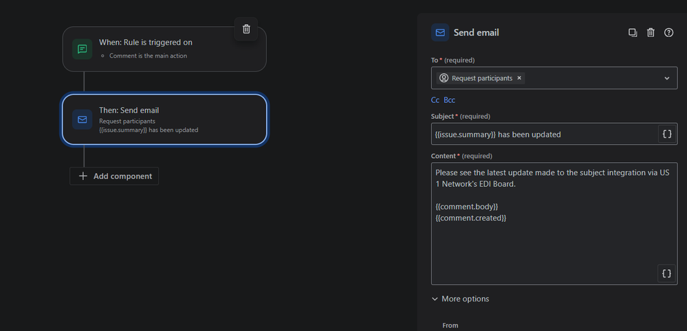

I've created a Service Project to communicate updates made to projects with Participants. We create the work item, include the associated external customers via Participants and send updates via email automation when a comment is made on the work item.
What I've found is that when an internal comment is made (which should only be visible to internal users), it is sent to the participants. I believe this is directly related to my rule and not a role that the participants would need. (Could be wrong)
Example of my rule:

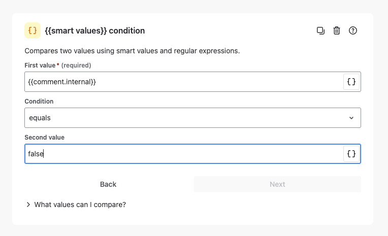

You can check the smart value {{comment.internal}}. Send the mail when the value is false.
Tyler Salerno
July 28, 2025
That worked perfectly, Thank you Trudy.
