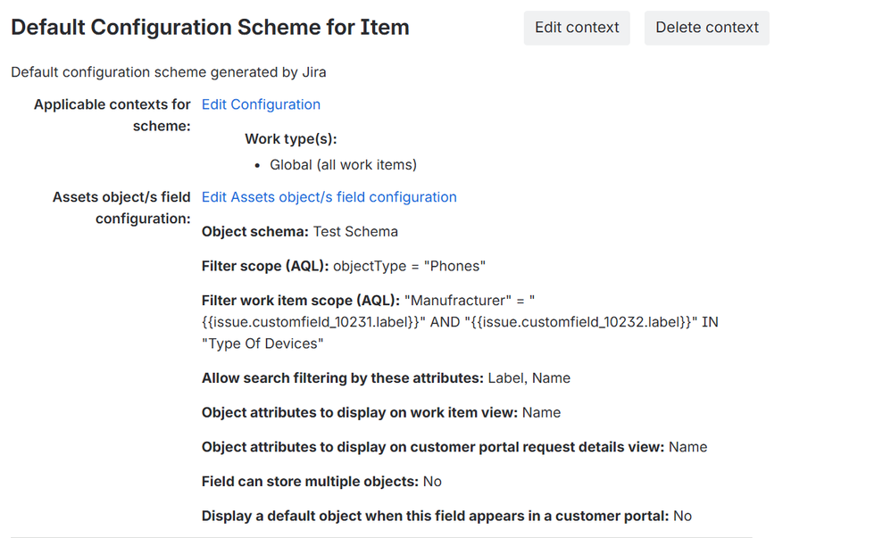

Hi everyone, I have a query regarding jira assets for using filters in asset fields.
Shubham Kumar
April 9, 2026
scenario: we have two object types in schema 'Manufactures' and 'Type of devices'. In the third object type 'phones', there are various objects that are linked to objects of manufactures and type of devices. Now, using these asset objects through asset field in the portal forms, I am able to get two field Manufactures and Type of devices populated. In the third asset field 'Item' in forms , it should only display the object based on the selection of the above two field. the filter work item scope used is : "Manufracturer" = "{{issue.customfield_10231.label}}" AND "{{issue.customfield_10232.label}}" IN "Type Of Devices".  But I am unable to populate the Item asset field.

I'm with @Marc -Devoteam-
Likely we need more details but based on assumptions these are few things to check:
1. The attribute has to be first and the value has to be at the end, so
becomes
"Manufracturer" = "{{issue.customfield_10231.label}}" AND "Type Of Devices" IN {{issue.customfield_10232.label}}"
2. You are not using placeholders. This is necessary to use issue filter scope, so
becomes:
"Manufracturer" = ${issue.customfield_10231.label} AND "Type Of Devices" IN (${issue.customfield_10232.label})
3. You have to make sure the fields you are referencing are supported. They have to be certain system fields or asset fields only. If they are supported (asset fields), then you can change it so that
becomes:
"Manufracturer" = ${issue.customfield_10231} AND "Type Of Devices" IN (${issue.customfield_10232})
Note too that if you did want to match by the label you have to add a part so that it matches for every single object and not just one, that is why matching by key is easiest. The asset field and the asset attributes in the backend are storing keys, so you don't need .label
4. Make sure everything is spelled correctly and it may be case sensitive. Is Manufacturer spelled the same way on the asset attribute? Is the T, O, and D all caps on the asset attribute?
5. You just need to list the customfield_id not issue.customfield_id
becomes:
"Manufracturer" = ${customfield_10231} AND "Type Of Devices" IN (${customfield_10232})
Hope this gets you to a starting point:
You can get more info here: https://support.atlassian.com/assets/docs/configure-the-assets-object-field/
