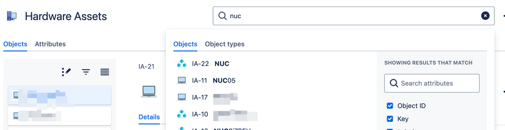

1. I'm embarrassed but I'm not exactly sure where you want me to navigate on this one.  Is it the Assets area and then the search in the upper right?

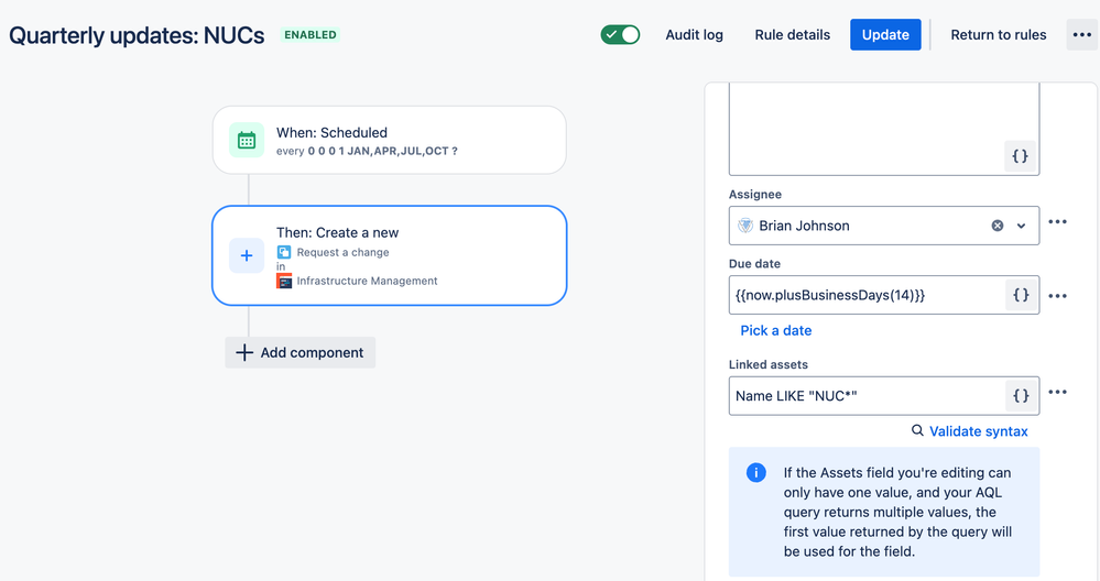

2. In my rule I'm trying to automate, I only see the option to edit the Linked Assets field with a query - not sure how to add several assets individually?
3.  Ah shoot, I think in this step you are talking about what I just showed in step 2.
But maybe these screenshots will help you see just how far off I likely am :-)
