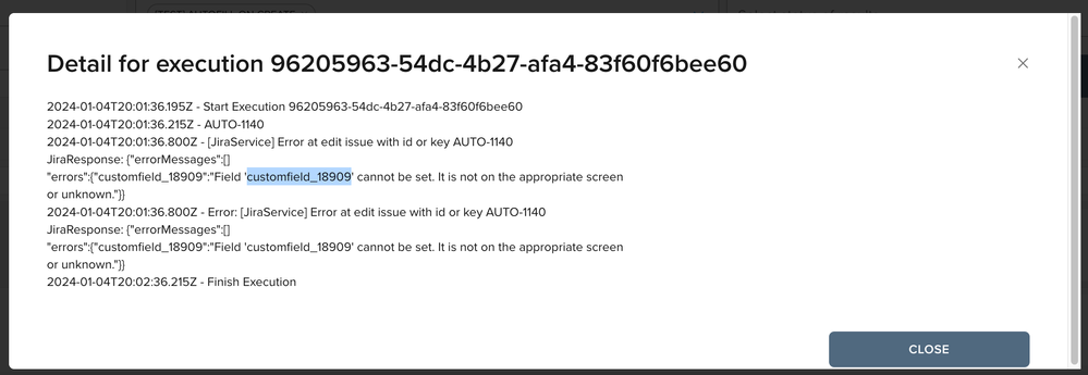

We are doing an integration outside of jira automation, because we are having performance problems in our instance.
This automation consists of copying some attributes from the assets to custom jira fields, due to the issue of exporting and not bringing the values.
But these fields that need to be filled in by this automation are only on the preview screen, because they can't be edited and we run the risk of losing the original information.
But when we run this script, it returns an error because these fields are not on the editing screen.
Do you know how we can solve this?
Note: The user we are using has admin permission for the instance and not org.
Thank you very much in advance!

The message states the the Custom Field that needs to be set is not on the screen used for all or a specific issue type on the project with the KEY auto.
If you are able to access the project details of the project with key AUTO, you can see the issue type screen scheme and it's related screen scheme(s) and scheme(s)
The the screens and add the Custom Field with ID 18909.
