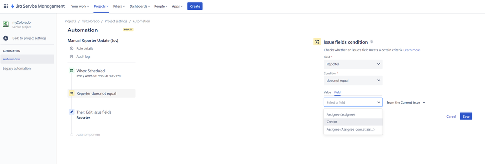

that's a good idea, do you have any examples? When I go to automation and look for my customfield, it is not giving me an option to select my customfield. Am I looking in the correct area?

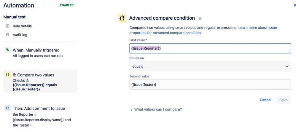

Hi @JayJuan Jones ,
used the advanced field compare. example below...
JayJuan Jones
August 17, 2022
that almost worked, but the reporter is being returned like this:
qm:f64841d3-9dd9-4d47-b4c9-4aa723459311:63ad5fd8-7597-4181-89c6-ead7c07dbd10
instead of the actual name, any more ideas?
