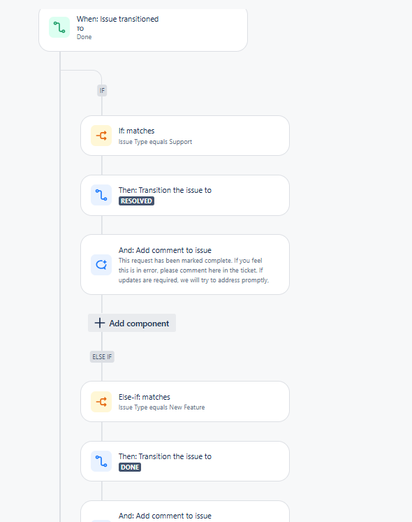

Hi @Grace Dowling I would suggest you use the IF Else Condition based on the Issue Type.
Condition IF> Issue Type = Support
Action> Then Transition to Resolved
Action> AND Add the Comment
       Else Condition> Issue Type = "New Feature"
       Then Transition to Closed
       AND Add the comment
Grace Dowling
January 17, 2025
Thanks do I need to add the project name / linked issues?Updated screenshot.png
Manoj Kumar Gangwar
January 17, 2025
Now it looks good. Please test and let me know if it works as expected

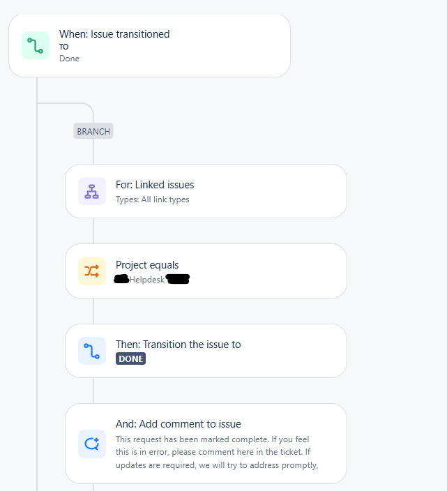

Yes, so this is the rule we had before, which would automatically transition tickets to done on JSM, when the corresponding ticket was marked done on JSW and a comment was added. The problem is that not all tickets have the same type of "done" status, as support tickets closing status is resolved and not done. So as a result, the below existing rule doesn't work, because it does not account for JSM having resolved tickets, only done. In essence, yes, the goal is to account for the various types of requests on JSM and transition it to its closing status, while adding a comment.

Manoj Kumar Gangwar
January 17, 2025
Thanks for explaining. Please add the linked Issue Branch and Project condition in both the IF Else conditions.

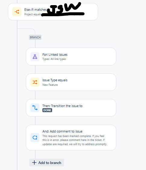

Grace Dowling
January 17, 2025

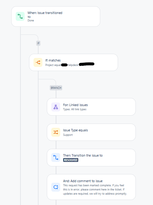

Here is what I did, I tested and it didn't work, so I think I am misusing the if/else statements.Screenshot 2.pngScreenshot 4.png
Manoj Kumar Gangwar
January 17, 2025
Please add the Project condition after the linked Issues Branch then test. Please configure the same as per my attached screenshots and then test
Grace Dowling
January 17, 2025
Got it and it works! Thank you so much!!!

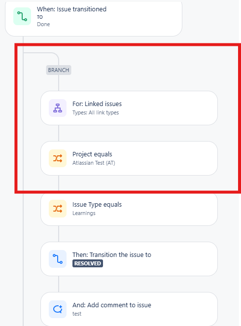

Grace Dowling
January 17, 2025
The above doesn't work, so I added for linked issues all link types and project equals helpdesk, but still nothing.
