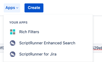

There is no option for querying based on the date of Comments without using a third party app. If you are not getting an error message when you use "commentedOn" in your filter, then you already have a third party app.
If you look under the Apps menu, do you see entries for ScriptRunner? If so, that is the third part app that supplied the "commentedOn" and "commentedBy" keywords.

I really think the issue is with the third party app that has provided the commentedOn keyword. You need to figure out which app that is, and contact their support team directly about this.
Thanks for the feedback. I appreciate it :)
If indeed the CommentedOn keyword is provided by ScriptRunner, then I need to find a different solution to get what I need.
I checked and was told this addon will be removed soon from our Project :(
So thanks again for the replies.
