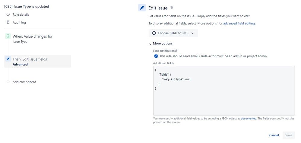

Hello everyone! I have a workaround that's working! It's an automation that simply sets the "Customer Request Type" to "Null" when the issue type changes.
Work around:
Create a new automation:
  1. Use the Field value changed the trigger
  2. Selecting the Issue Type field for the Edit and Transition operations
  3. For action, pick Edit Issue action
  4. Select More Options and paste de JSON below:
    "fields": {
        "Request Type": null
And wala! 🎉 My validator is now working, thus blocking my team from closing an issue when it's been moved, and the customer request type has not been re-populated. Hope this helps!

This does not seem to work anymore. An Edit Request Type action has been added, which does not allow for the JSON data to get added to trigger the workaround for the validator.
I am essentially trying to solve a similar issue. Whenever the request type is empty, the issue should not be allowed to transition until it has been set to a valid value.
Similar to the original case, when we change the issue type of a request, the request type value gets emptied, and I have not been able to find a way to either prevent this from happening or force a value to be set in any way.
Oscar Travieso
September 13, 2022
Hi @Michael Nassette I hope you are ok, the method is still working, in this new Edit Request Type action you can click on More Options and paste the JSON and voila!

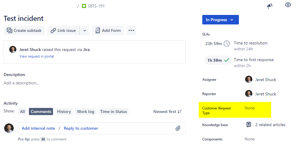

So, the ticket is moved to another issue type, the request type shows “None”, but if you go to the issue navigator, the request type is still visible, so in the backend, the value is still there and the validator doesn’t recognize the field as empty, that’s why it won’t work:

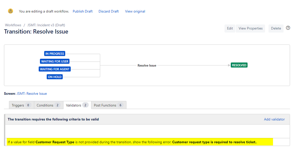

I have the exact same use case. Here's my validator:
On my test ticket, you can see here the request type is blank (after switching the issue type):

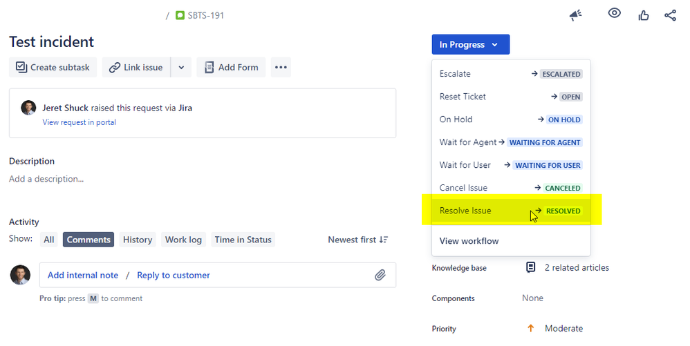

And yet, I still have the ability to execute the transition:
If anyone out there has a solution or work around let me know!

May 25, 2022
Hey, This is still working as with the first suggestion - "Edit Issue" and not "Edit Request type" - the automation changing the RT field to be empty and than the validation works.

  • i use the validator "Field Required Validator Field  / must not be empty during the transition."
