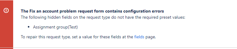

Hi,
I am getting a exception when I select project setting. The exception is regarding the field Assignment group(test) I am unable to remove the field from request form "fix an account problem".
I don't need the above mentioned field in that request form. but I am unable to remove as the field is created from Jira end.
Any solution to fix the above requirement ??

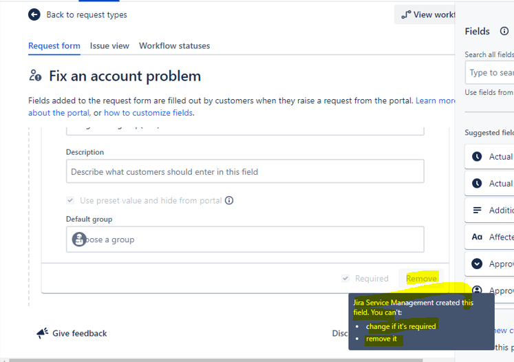

Mohammed Haneefa Farook
July 18, 2023
Hi @Rilwan Ahmed
Thank you for your reply.
I am not getting the remove option as the remove button is disabled which is provided below.
Is there any other way to fix this exception ??
Rilwan Ahmed
July 18, 2023
Hi @Mohammed Haneefa Farook ,
Seems the field in required field in screen context.
Go to project settings --> Screen.
See if the field is marked required.
Now remove the field from create screen and come back to request type and remove here as well.
