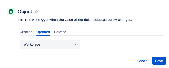

Hello, I would like to extract object type through automation. Currently, I am using Object updated trigger through Global automation.
This trigger doesn't let using AQL, so I have to get the objectType/category of the object retrieved and use Advanced compare condition to filter out the needed objects. Unless you can suggest simpler ways to do it. I can access the object with smart value {{object}}, however, I can't seem to get the objectType attribute. I couldn't find information about it in the documentation. Thank you for your help in advance!

Hello @Aleksandra Leesment ,
According to this documentation, it seems that you can access the object's attribute through this syntax: {{object.(attribute name)}}
Can you try this and let us know?
Aleksandra Leesment
October 26, 2023
Managed to get the category by using {{object.objectType}}.
